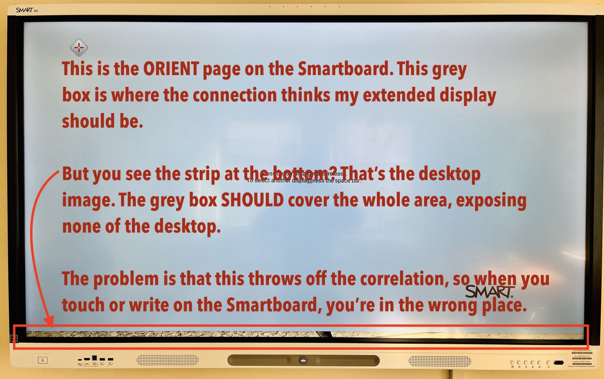

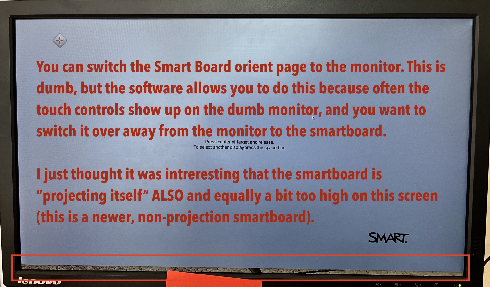

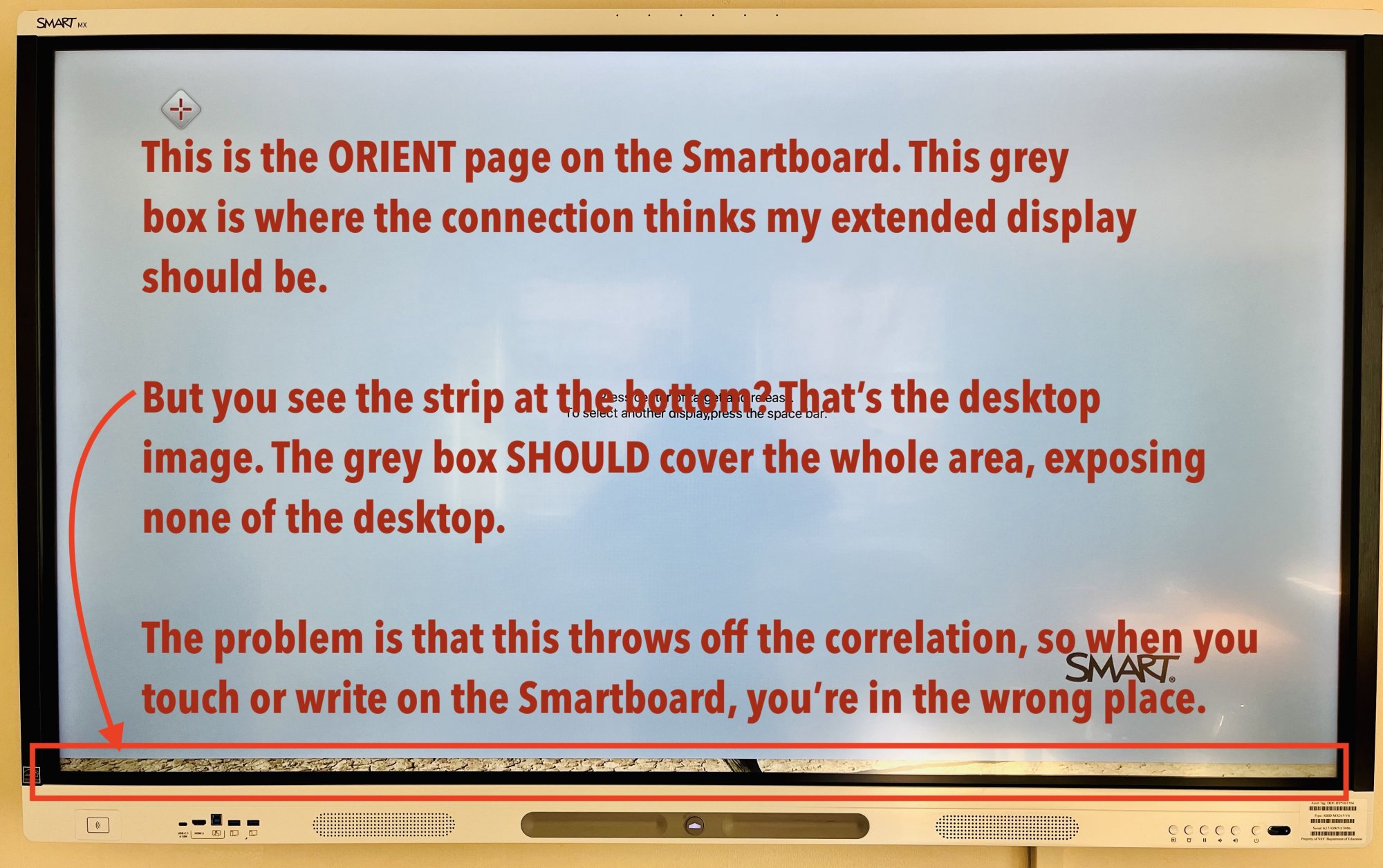

In my classroom run a smartboard connected to my Mac Mini (HDMI and USB-A for the touch controls), extended display, works fine, happy with my set up.
Until today! I upgraded to Sequoia on Tuesday. Everything was fine on Wednesday, but today (Thursday) the freakin' display is now about an inch high, so I have to guess where to touch, and handwriting is super hard! When I used the orient tool, I could see the problem: the grey orient screen with the touch targets is raised up, leaving an inch at the bottom.
Things I tried:
  • Turned everything off, unplugged, turned back on, plugged back in.
  • Made sure Smartboard software/drivers are up to date
  • Tried the "orient" page again and again
  • Checked (and tried changing) the setting on the display resolution
  • Tried mirroring display instead of extended
  • Tried switching which one is the "main" display
  • Emailed Smart tech support (haven't heard back)
Posting here because maybe other people are seeing weirdness with other (non-samartboard) displays, since upgrading? Or just some smart people here might have ideas for a fix?
Pics attached.

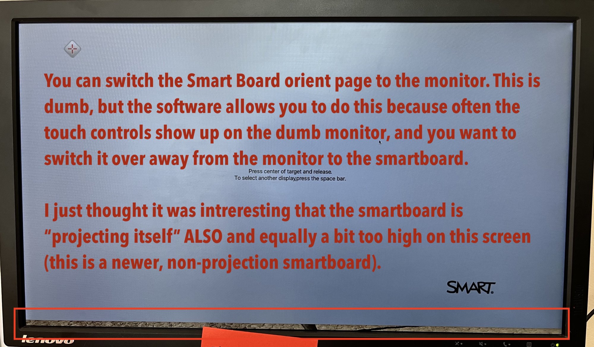

I did get the orient to work correctly, but it had to be in extended display mode. Once in extended display mode go to the smart menu icon, choose orient, then it will open on the laptop. Tap space bar once to go to the other screen and notice that it has the bar at the bottom ( ie it looks like the OP where the gray screen does not cover the whole screen), tap space bar again it will go back to the laptop monitor, and strangely enough tap space bar again and it will cover the whole screen.
Im still looking for a solution to this issue so that the teacher can use the board in mirror mode not extended.
