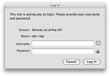

Still doesn't work for me. I get this message instead of a box asking for my PIN:
attachment.php
Any suggestions?
