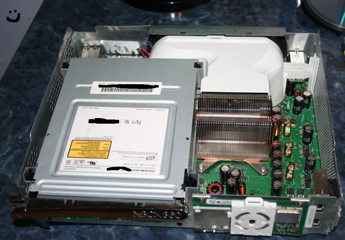

I've ended up with a friends broken 360, it fell off a high shelf onto a hard floor. What it was doing up on a high shelf I've no idea. All I know that nothing on the motherboard appears to be broken, short of a few scuffed edges around the unit (actually quite surprised at how small a 360 really is).
It's promising in that the machine turns on, with a green light and everything. Yet it dies about 10 seconds later. My guess is that the fan or some kind of cooling device isn't working and therefore shuts off the system as the temperature rises.
On a side note it's quite funny seeing a smashed 360 working whereas a previously fine 360 would get the Red Ring. The hardware itself seems quite sturdy.
Anyroad. if I fix it - it's mine. Apparently. I'd just need to buy a HDD (the previous drive doesn't work at all) and a Live subscription. It's a long shot... but has anyone come across something similar or have any ideas of whats cutting out the 360?

Anywho. Attached a pic. And I'm expecting a 360 Lite in the coming years. They could really make that thing smaller!

Just try snooping around in there, check the fan power cable that plugs into the mobo, if that came loose in the fall, then all you would probably have to do is reconnect it.
Bit of an update, since my brother disconnected a lot of stuff himself trying to fix it the red lights weren't showing up. It now shows 2 red lights and I've found the fan has a blade missing (though I don't think this would have much of an impact).
Google tells me 2 lights means overheating. I even stuck the 360 into the fridge and turned it on, but it still had the red lights.

I've been reading up and it turns out the heatsink might have become dislodged from one of the big chips. It's missing a one of the screws underneath so I'm hoping this will fix it. Like I said - it's not giving me the hardware fault ring so I've got very high hopes with this! But to score a £200 for free is fantastic! We even got a working wireless controller 🙂
So... Anyone know where I'd get another one of them strange screws from? And a matching screwdriver?
