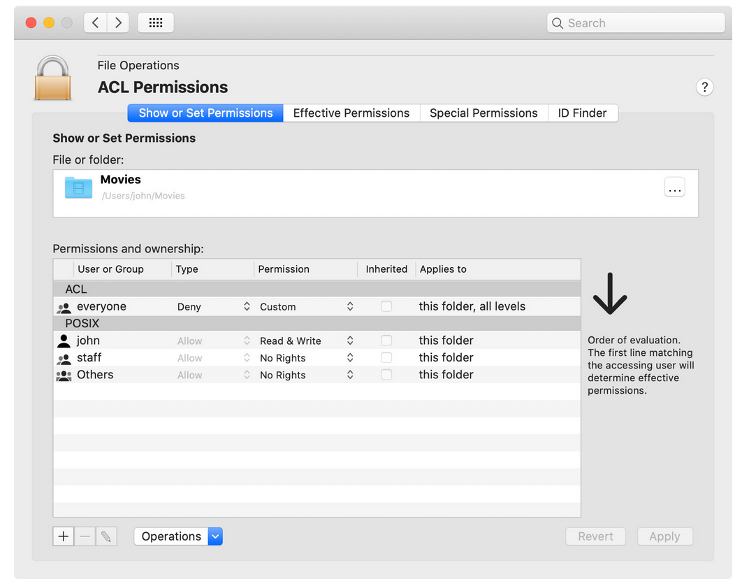

This is (was) a fairly common problem for Mac OS file servers over the years. Folders don't seem to inherit the correct permissions. I remember this back to 10.5 at least...
If you want to see and manage permissions more easily—especially ACLs, which are invisible in the GUI yet take precedent over POSIX permissions—I suggest a good admin tool.
Server had a fairly good permissions manager pane up to about 10.13. Sadly, Apple killed it off. TinkerTool Sytem is the only tool left I am aware of with all features needed in a good interface:
