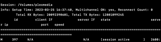

Hi- I've been able to get it to work. I'm not sure I totally follow your setup; LAG should be turned off to use multi channel but I may missing a variable/not understanding your hardware in this scenario.
Anyway I have it setup between a mac mini and an unraid machine. These three lines enable multi channel, specifically only for your wired connections (if you have wifi on as well it would only be for redundancy in this scenario). It's just a couple lines in your nsmb.conf file, you can read here
