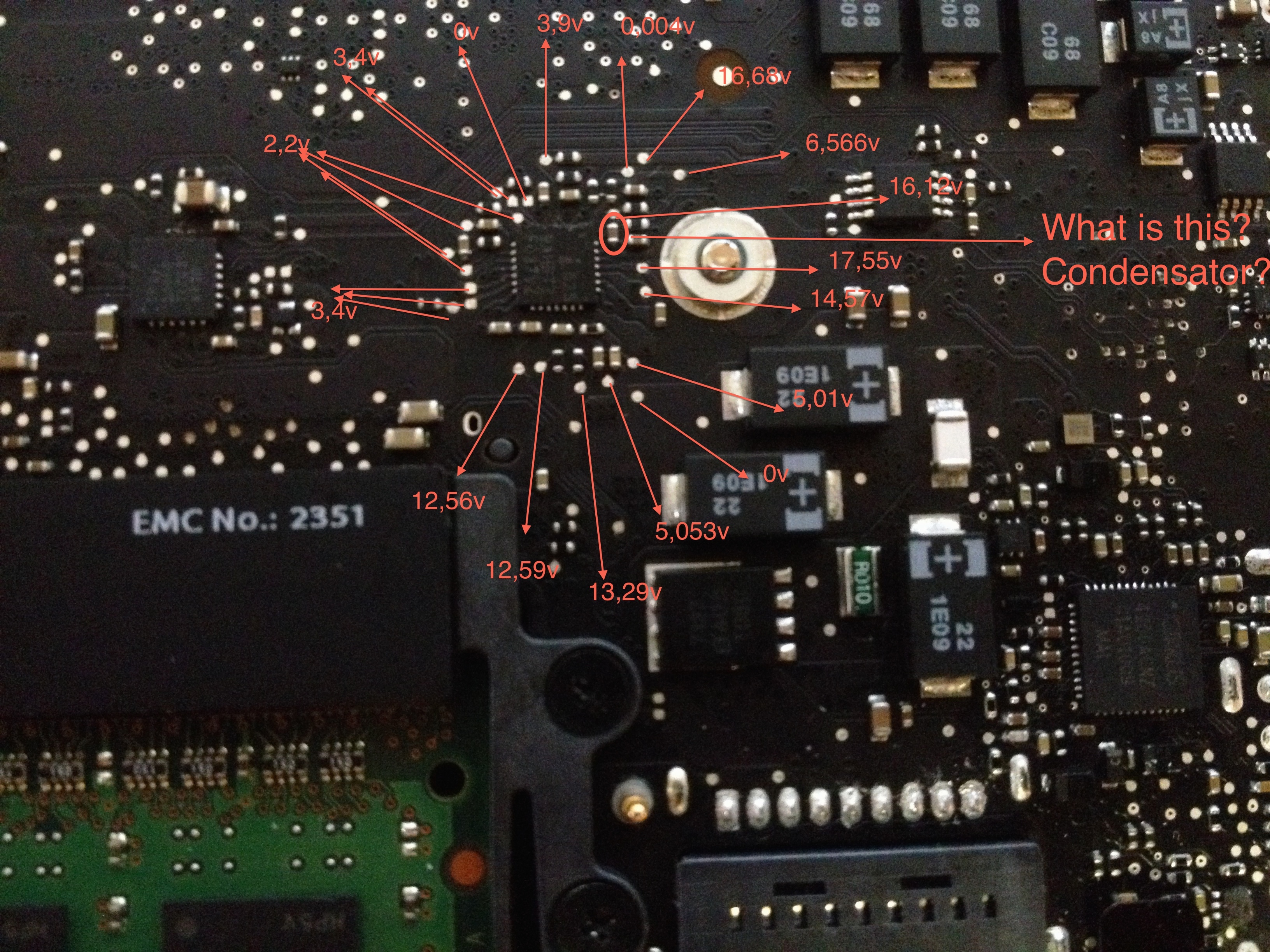

Here is some voltages around charger chip. Magsafe on and battery connected.
edit. and for additional info for everybody who wants to help: mid2010 mbp, doesn't charge, detects battery and tells cycles etc. works alone with battery, works with battery and magsafe, doesn't work with magsafe only (except smc bypass mode)

I've put a red circle around this green component in the picture. What is it? Is it a capacitor? Measuring it won't give any value and if I measure continuity the signal goes right through an multimeter beeps.
its a capacitor..
Usually if it was not corroded by water damage, if you do not measure shot, it should be fine...

its a capacitor..

If you do not measure short... ( 0 ohms or close),,, meaning that a capacitor that has close to 0 ohms is a bad cap... in short.. like a bridge or 0 ohms resistor.
This happens still if you have changed the charging ic?
