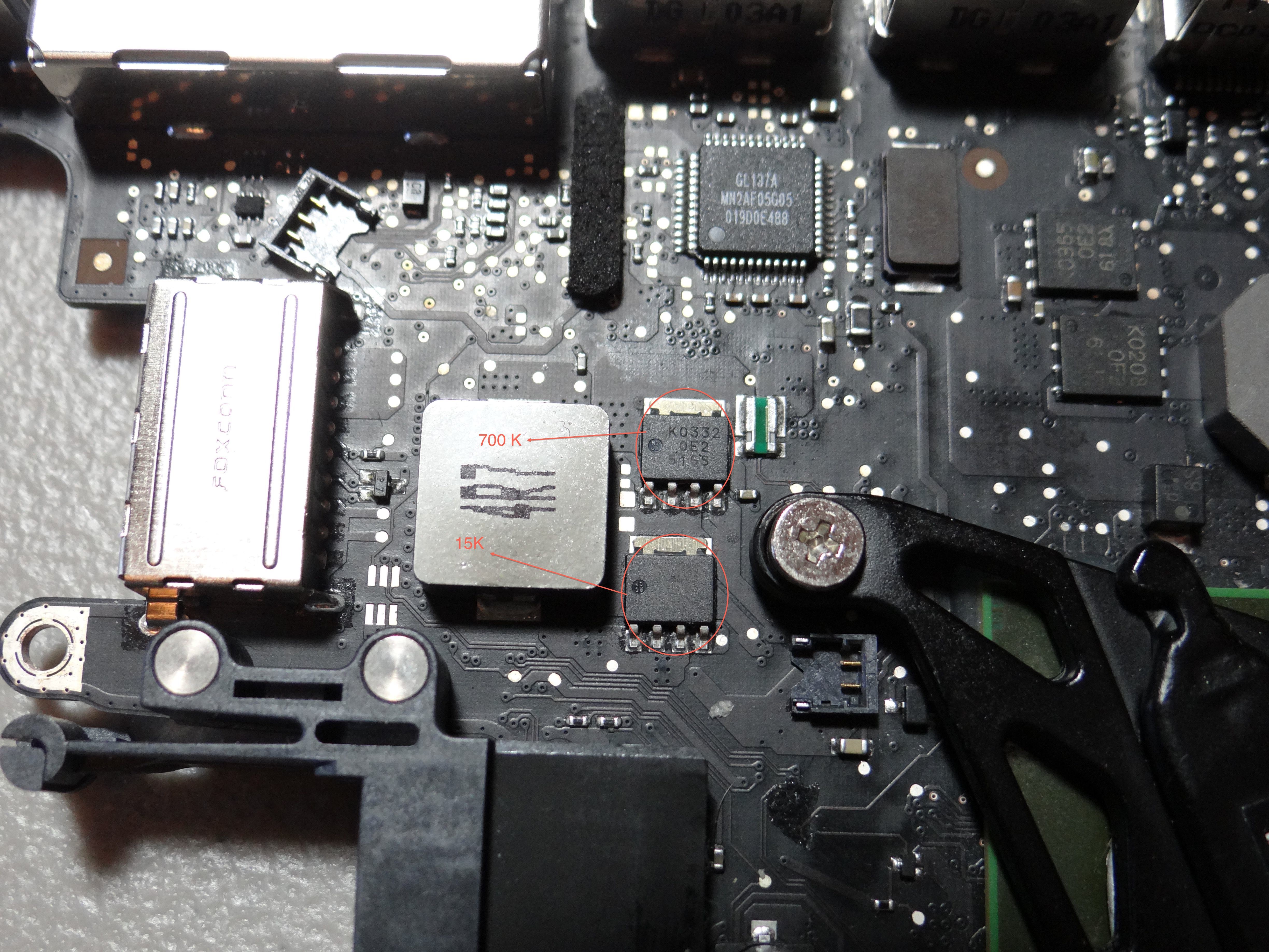

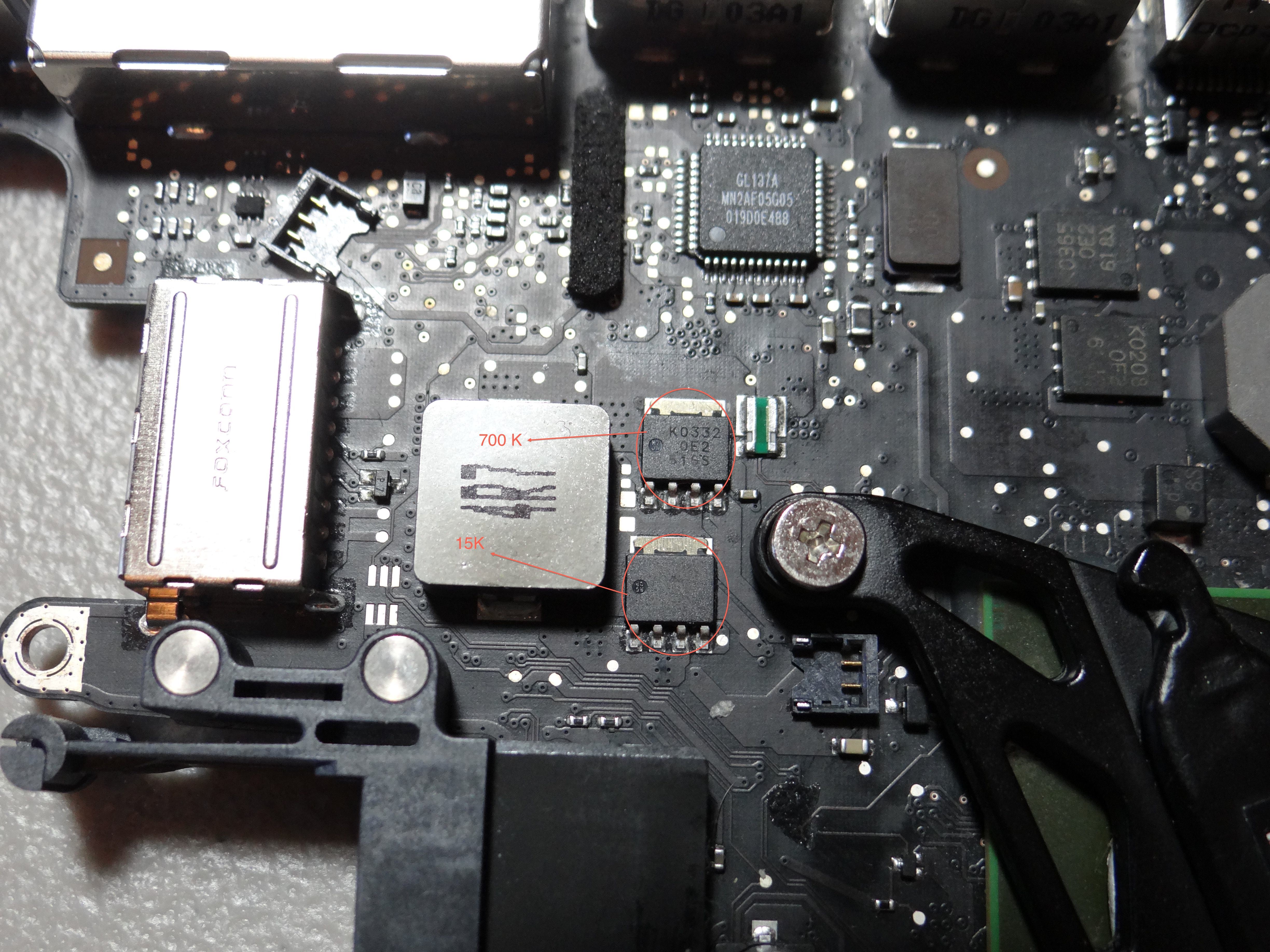

With power off check the impedance across Q7030 and Q7035. Check D-S, G-S, D-G on both FET's and see if there is a low impedance indicating a blown FET.
Another quick check, if the impedance Q7035 D-S is low is to lift off the fuse and see if the low impedance is after the fuse or before the fuse. That wilt ell you if it is the charger circuit or if the problem is further down stream on one of the board's power supplies.
DADIOH: HAVING THE SAME PROBLEM WITH MINE. Checked both mosfets see photo for values. I do not know where the fuse is at. Do you know? I am guessing that the bottom mosfet is no good since it has the low resistance value. Should I just replace it.
On a side note: Since I am a novice at all this. What is the best way to remove one of the small resistors. I have tried with my soldering tip and solder wick, but could not get it off. Should I be using a hot air tool instead. Used my Hakko at about 390 c.
