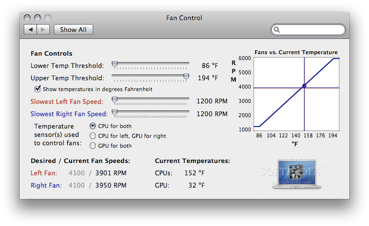

I'm actually not sure, now that you ask. I've installed a number of "fan control" type apps until I settled on smcFanControl awhile back. So, the question is, I guess, what is Fan Control? 🙂 At any rate, I like the settings for this mysterious app, since it allows me to set a high and low setting for the temp and a minimum speed for the fan. smcFanControl doesn't work like that from I can tell.

It can look like this:
But it currently looks like this:
And can be located here:
http://www.lobotomo.com/products/FanControl/
and found via
http://www.google.com/search?hl=en&...&spell=1&redir_esc=&ei=JoehS4jEFsqa_QbU1YHZDQ
and found via

Which settings do you recommend for a MacBook Pro? Lower Threshold and Upper Threshold means max and min temps i want to have?

I used SMC Fan Control before I found FanControl, and as SMC had some problems with its fan speed control, it would not slow down, even though I set it to slow down, and only an SMC reset would remedy that, I found FanControl to be much nicer and more easygoing as it does not f-almost-ubar.
