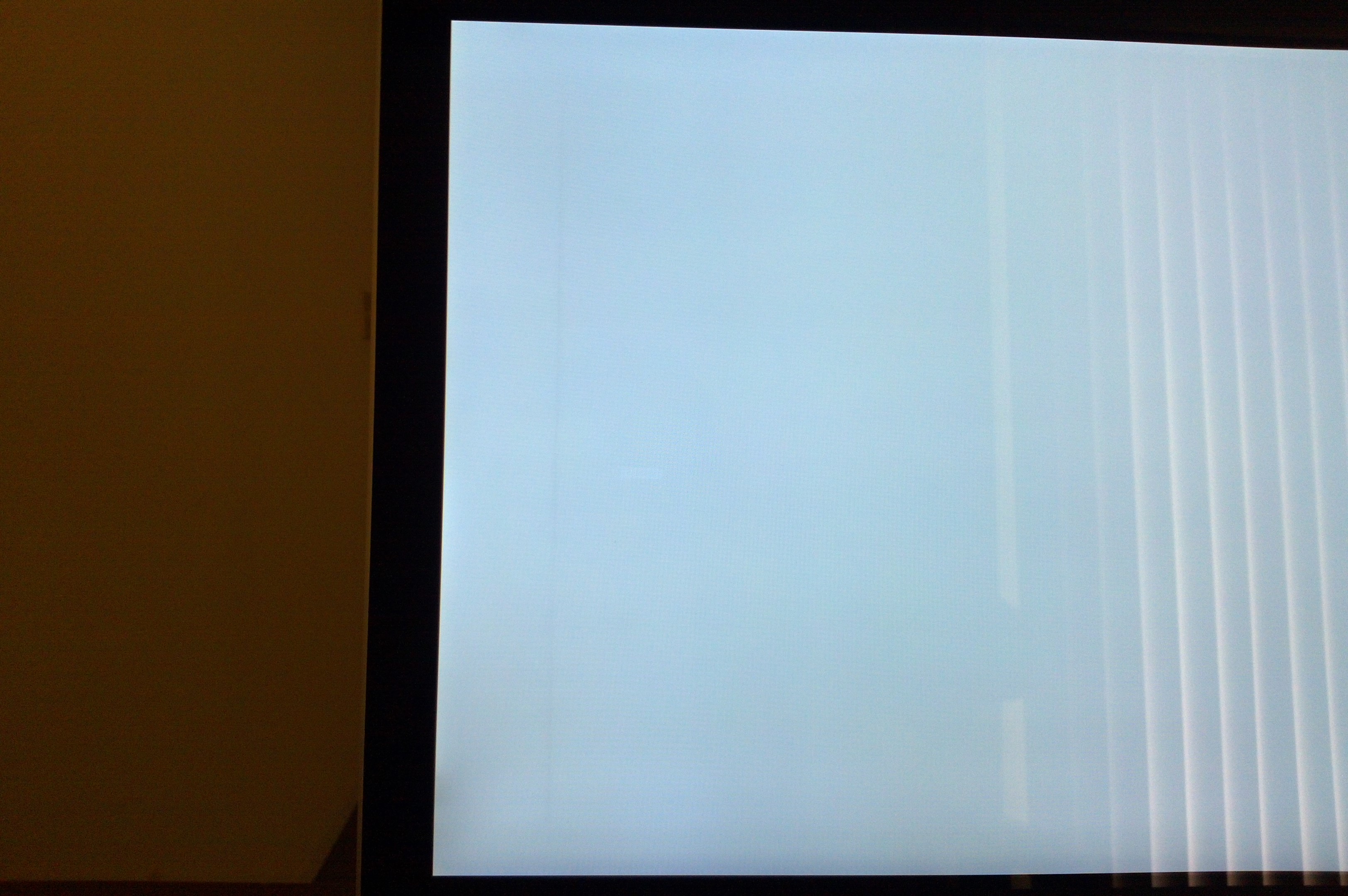

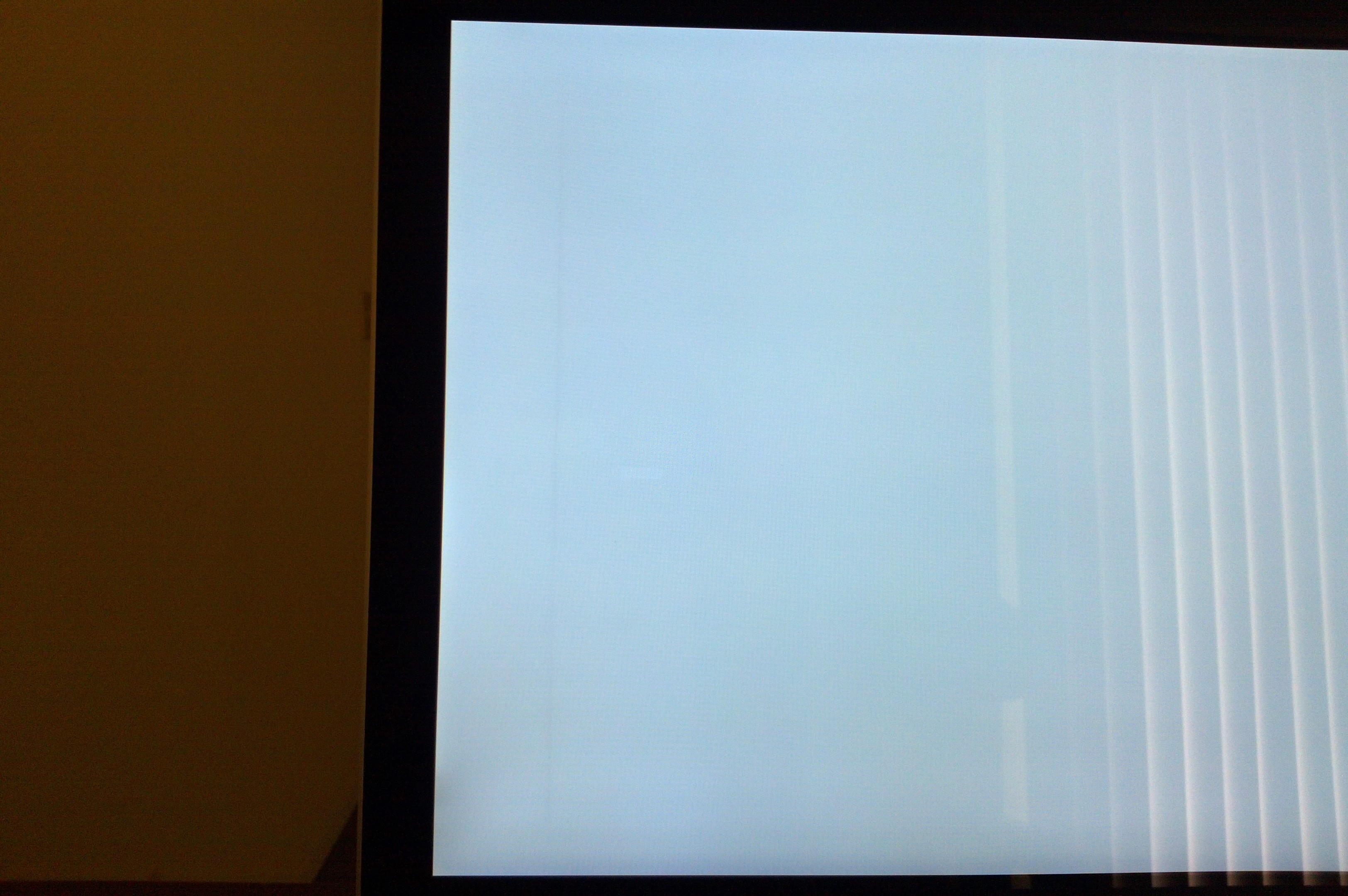

It seems the smudge is coming back. I attach a picture where you can clearly see the dark line (the dark line on the left. The right are just reflection of the window shade🙂. It is now mysterious to me what the problem is. Again, the dark line is not there when the display is cold. It only appear when the display is on for a while and is warm. It will disappear if I shut off the display and let it cool for a while. But it will re-appear when it warms up. So strange to me.
