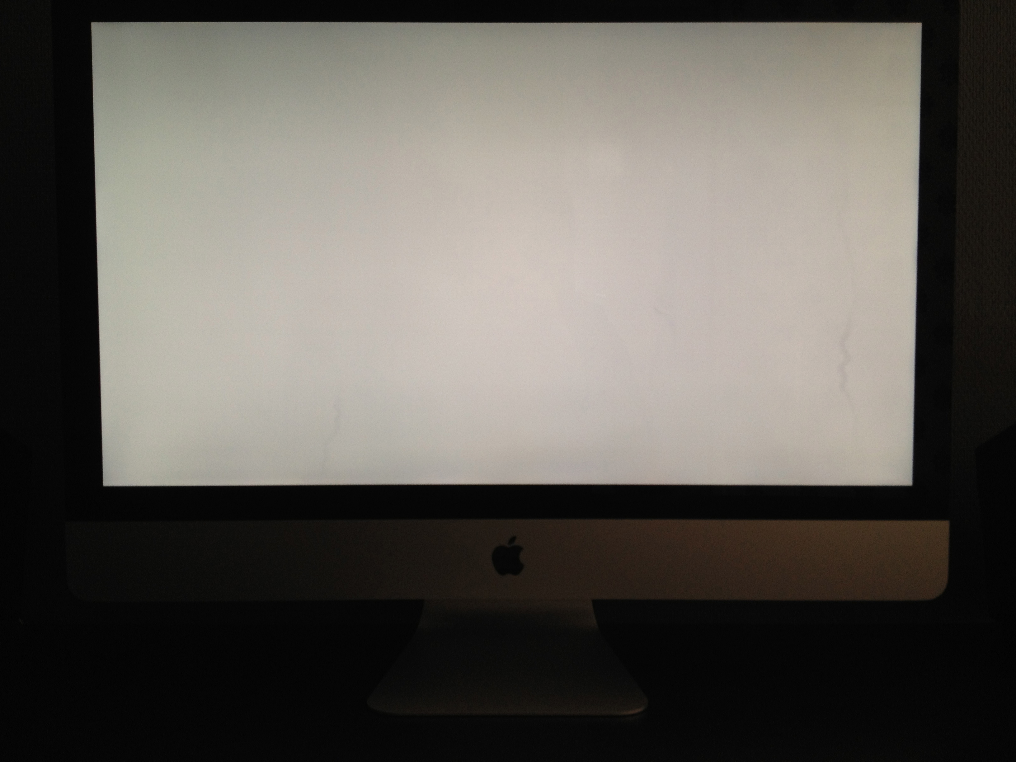

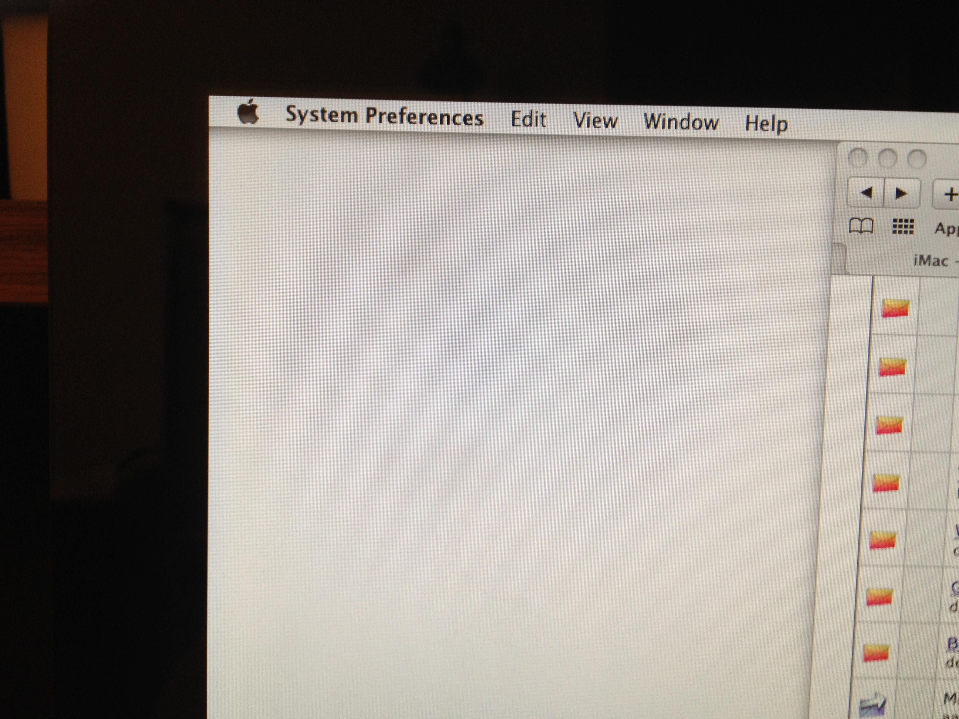

Hey guys. Just picked up a used iMac yesterday and love it so far but I have one issue. There seems to be smudges on the screen. I thought at first I thought it was just on the glass but I tried wiping it off and its still there. Ive attached a pic of it. What do you guys think? I don't know how much warranty is left on it.
EDIT: specs are 21.5" 3.06 i3

You can try wiping the inside of the glass, if it really looks like fingerprints. If it looks like black, dark smudges, it's probably the LCD panel and needs replacement.
Hate to tell you but this is a common and well known problem. (Although Apple won't admit it.)
Just search for iMac and "dust". The problem is dust getting in, between the backlight and the LCD panel. It can be fixed, but it's pretty scary to do it yourself and it will likely come back again anyway. It's one of the main reasons I am not risking buying a 2011 iMac right now.

1) Dust behind the glass can be a problem when the iMac is used in dusty environments, i.e. bedrooms. It is certainly not a common problem.
2) As stated by Fuchal, the external glass panel can easily be removed and any dust carefully wiped from the inner surface. Dust doesn't get behind the LCD.

Mine has dust inside the panel (as other threads have mentioned) - very, very annoying. I thought it was behind the glass, but was bummed to discover it wasn't after pulling the glass out and trying to wipe it off.

Mine is in for a repair RIGHT now for this exact same problem. I took it in and they said they'll replace the LCD screen. The genius described the problem as 'bleeding'. Luckily I'm under warranty so it won't cost anything but I've got the repair sheet and the total cost of repair is £379 (27" LCD: £355, Labor: £24).

Well I just took off the glass and wiped it down but still there. I guess Ill stop by the apple store and have them take a look.
