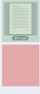

See this image:
attachment.php
If you drags and drop into the red zone...wrong! Preview shows both files in the same window, but it doesn't merge them, check the title bar, it says something like showing X documents, X pages total(I'm from Spain, so my SL language is spanish, I don't know what the English Preview should tell, but anyways, you get my point, don't you?), you need to drag the PDF into the green zone.

See this image:
attachment.php
If you drags and drop into the red zone...wrong! Preview shows both files in the same window, but it doesn't merge them, you need to drag the PDF into the green zone.

Okay, since I just installed Leopard I hadn't had much time to use the new Preview. Okay, I see the issue, it does work differently in SL vs. Leopard. There's a zone that you must stay in, in order for the PDF's to combine and it's outlined when you drag n drop to the sidebar. I can see some pro's to that if you want to keep separation.
