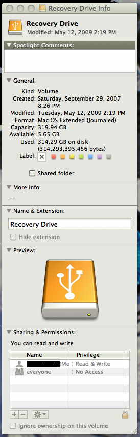

when you do finder/file/get info, aka in finder highlight icon and command I.
you will see ignore ownership on volumes. Yours is likely showing as the same, so you will need to click on the padlock, enter your user name and password and ignore ownership.
Short user name is the truncated one you see here and on your user folder inside Users, the long name is the one you type in.

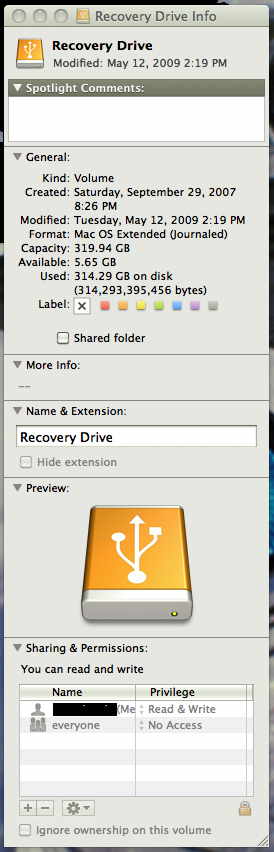

Ah ok, I understand, I wasn't actually looking at the HD in info, I was looking at the actual files.
