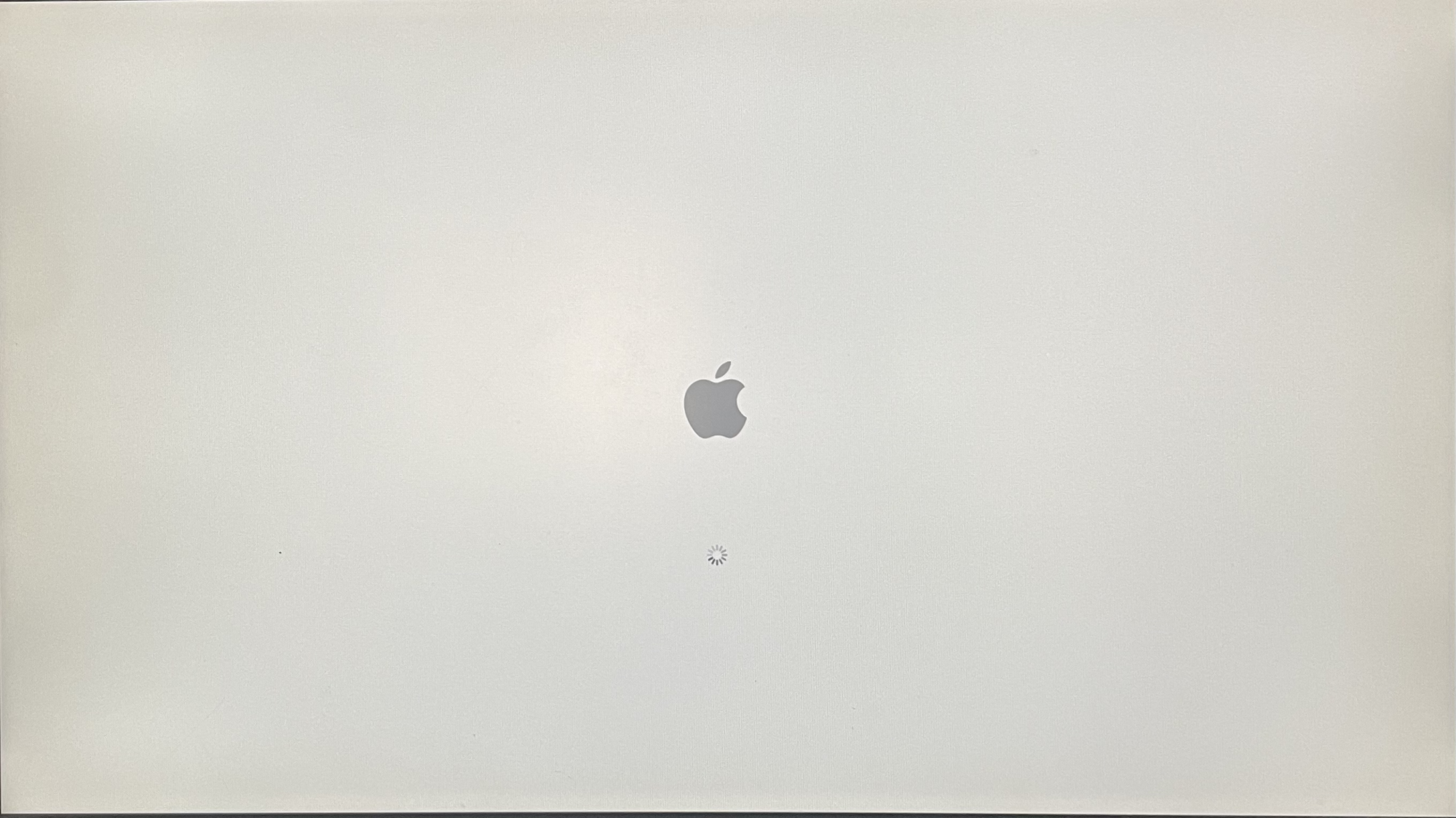

I'd like to downgrade my Mac Pro 5,1 from Lion to snow leopard. No matter what I've tried, it simply won't work.
I tried flashing a retail disc to a USB, and then booting from that, but it gets stuck on an apple logo.
I also flashed the disc that (supposedly) came with the computer, but it spins on the apple logo for a bit, and then shows a "no entry" sign in place of the apple logo after about a minute or so.

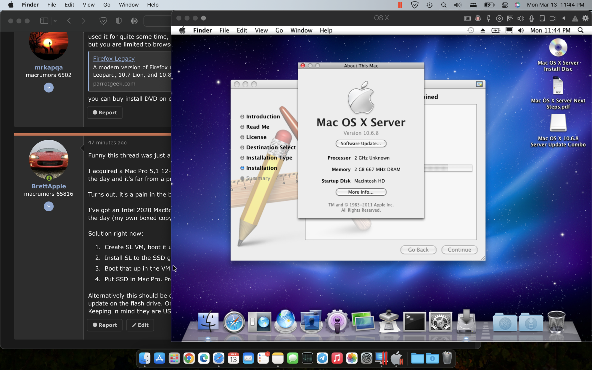

I acquired a Mac Pro 5,1 12-core recently and wanted to load the oldest OS possible because I loved Snow Leopard back in the day and it's far from a production machine for me.
Turns out, it's a pain in the butt! Why did I ever get rid of my 2008/9 era Macs!
I've got an Intel 2020 MacBook Pro 13" with Parallels though! And a retail copy of Snow Leopard and SL Server from back in the day (my own boxed copy!)
Solution right now:
  1. Create SL VM, boot it up.
  2. Install SL to the SSD going in to the Mac Pro via USB - SATA.
  3. Boot that up in the VM and install 10.6.8 combo update.
  4. Put SSD in Mac Pro. Profit.
Alternatively this should be do-able with USB Flash drive too. Install the OS to the VM or flash drive then use the combo update on the flash drive. Once done boot it up on the Mac and clone it to an internal drive with CCC or possibly Disk Utility. Keeping in mind they are USB 2.0 and quite slow doing this. But Snow Leopard is tiny compared to modern macOS releases.

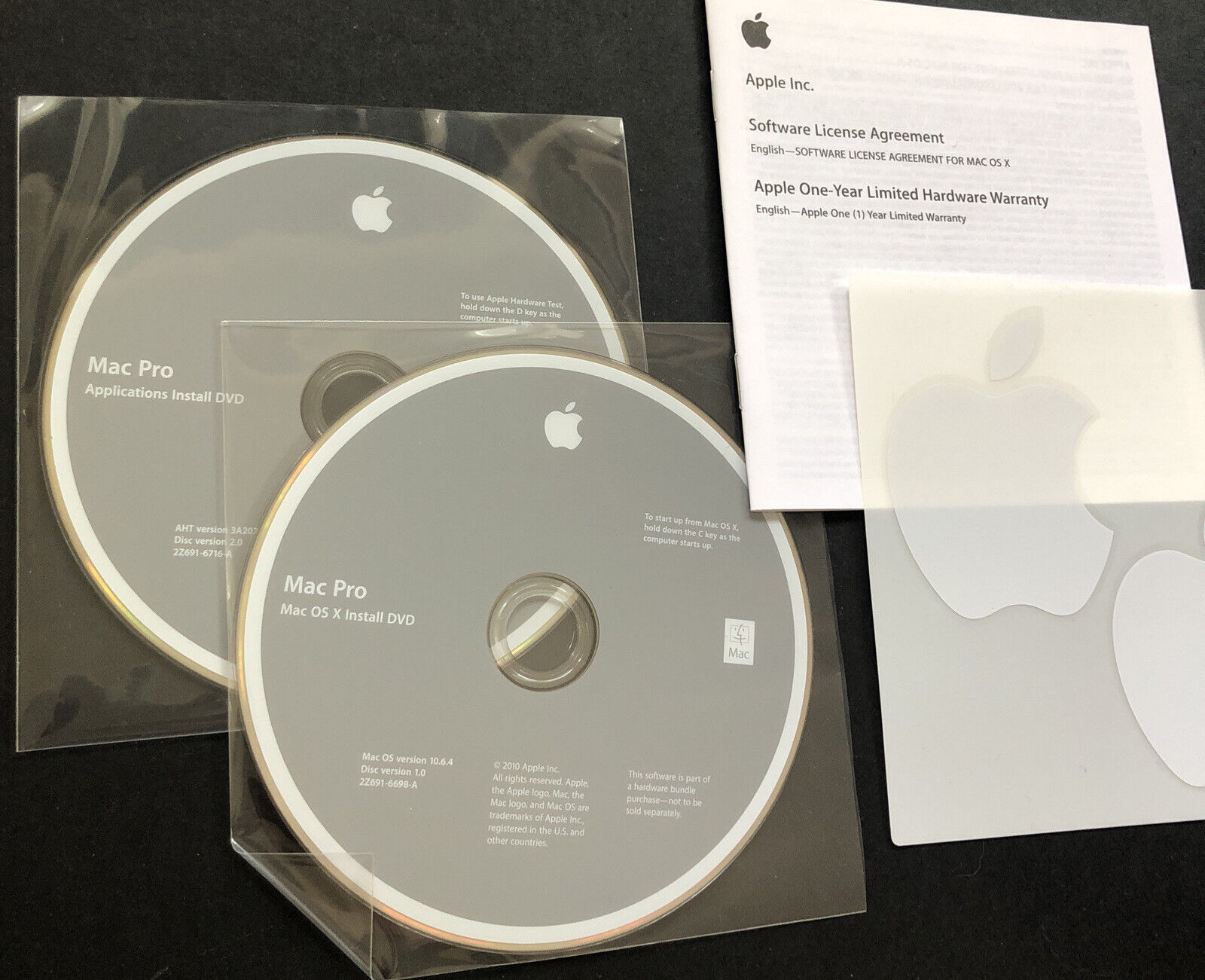

These are the original DVD's:
Apple Mac Pro (2010) Mac OS X 10.6.4 Install DVD & Applications Install DVD
Notes
Disk 1 2Z691-6698-A
Disk 2 2Z691-6716-A
Compatibility

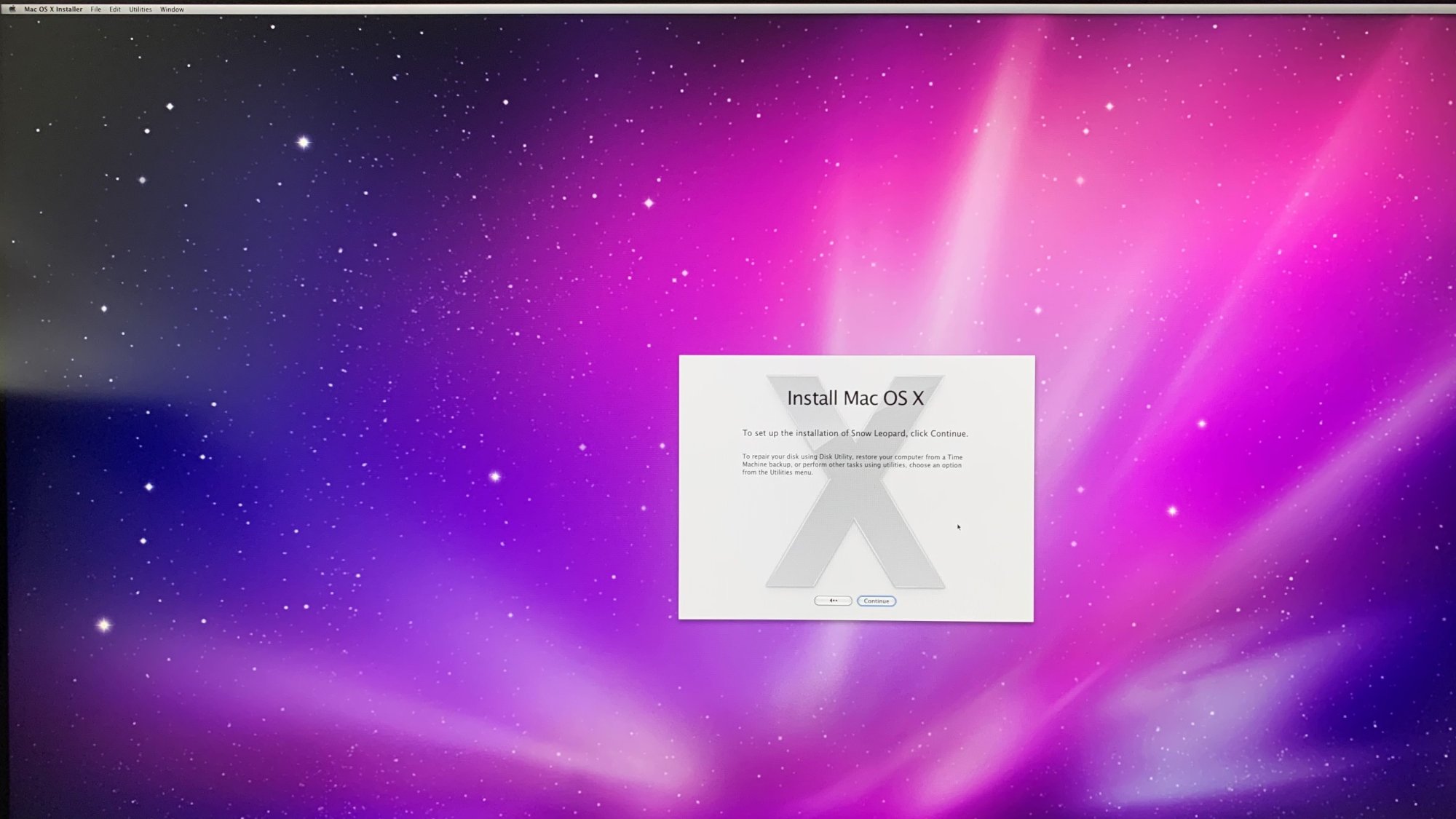

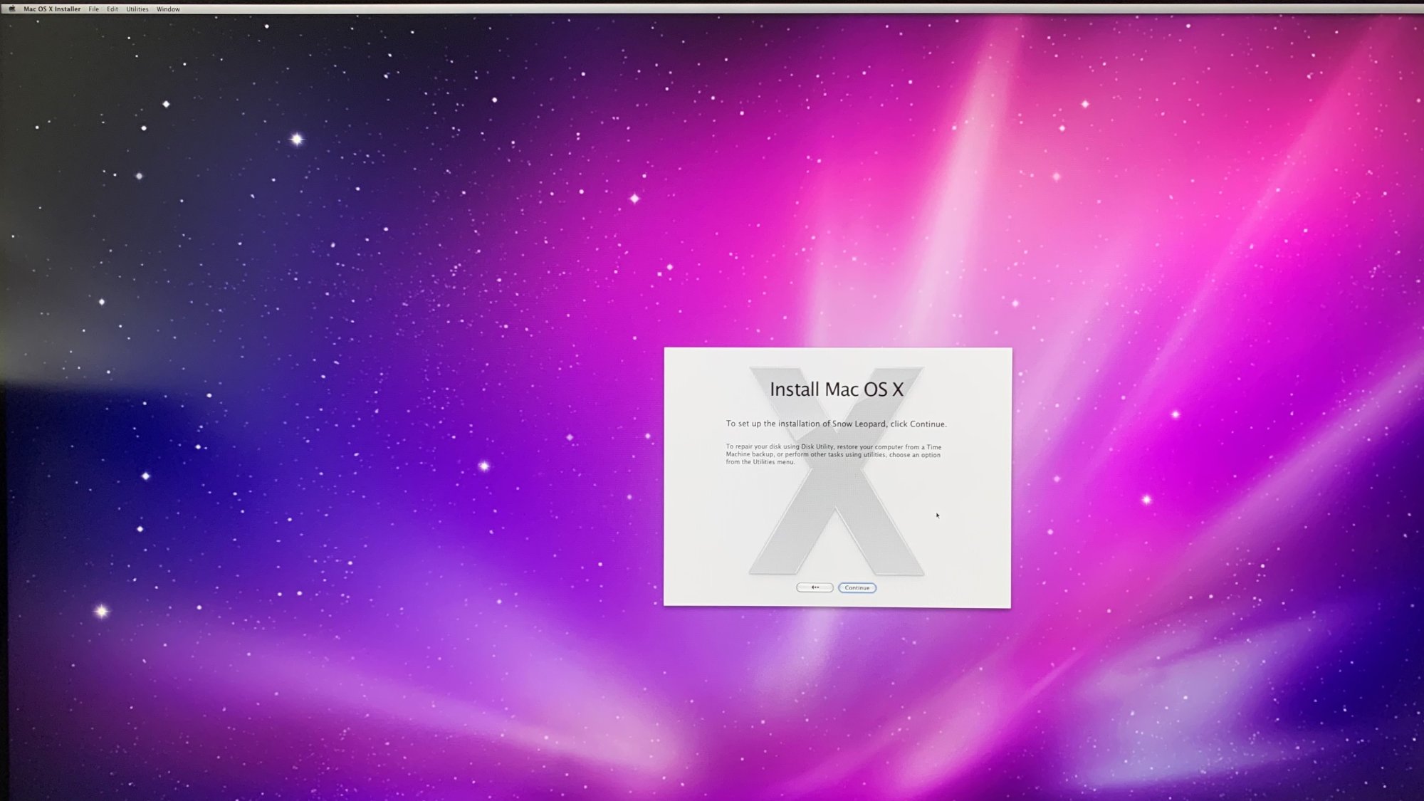

I was able to create a bootable USB for MacPro5,1 from the link in the first post:
Formatted the USB:
Code:
diskutil eraseDisk JHFS+ Untitled /dev/disk4
Converted the .toast file to DMG with disk utility and restored the DMG to usb:
Code:
sudo asr restore --source ~/Downloads/691-6744-A2ZMac_Pro_extracted/691-6744-A\,2Z\,Mac\ Pro.\ Mac\ OS\ X\ Install.\ Mac\ OS\ v10.6.4.\ Disc\ v2.0_2010\ \(DVD\ DL\)\ converted.dmg   --target /Volumes/Untitled --erase -noverify

These steps worked for me on my cMP:
Booted via OpenCore.

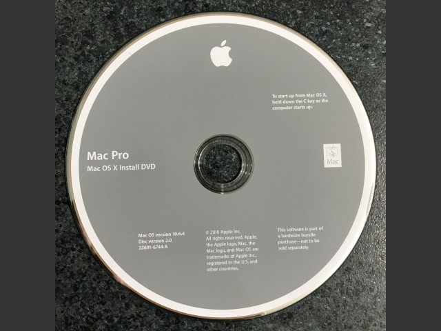

The download from Archive.org link above has different Apple part number......691-6744. (version 2.0) compared to what you listed above (Version 1.0)
Could not find a link to the Disc 2 (Applications)

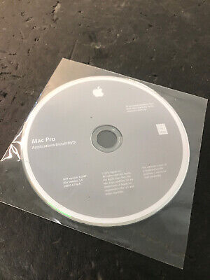

The Disk with the applications was selling on Ebay yesterday.
Just checked the distribution file. This image only supports cMP5,1:
Code:
var hwbeSupportedMachines = [
        'MacPro5,1',
Apparently there are 2 versions of recovery DVD's for cMP5,1 (assuming this is a genuine image). For cMP4,1-->cMP5,1 conversion one needs to verify the return value of this check:
Code:
sysctl -n hw.model
Edit: There is a Mac Pro DVD with this p/n so it is genuine too:
