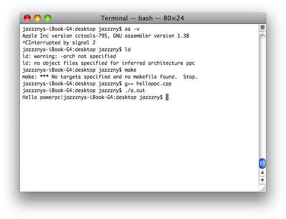

I have compiled a few of the most important projects that are required for a working compiler toolchain, which now means that Xcode 3.2.6 can be used properly (builds and links binaries, binaries work):
The following projects are mandatory for a working Xcode:
- ld64
- gcc (stock gcc is incomplete for ppc)
- cctools for the as tool
- gnumake
I have attached the binaries, and they need to be put in the proper locations after installing Xcode 3.2.6.

It was the cc1* binaries in gcc/libexec that were missing the ppc slice. GCC would first complain about as, then the cc1* binaries, then ld after each other as I was putting them in place.
