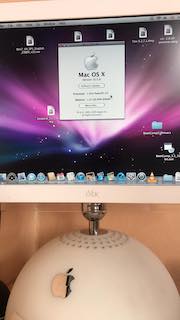

I have been trying to install 10.6 on my iMac G4 from 10.5.8, but have not succeed. Even though I was able to bring it up from Tiger to 10.5.8. I have bid the DVD installer 10.5 from eBay and will try again. I am also going to upgrade my HDD to SSD and install more ram as my iMac at the moment has 1.25 GB DDR Ram to 2 GB and my iMac is with 1 Ghz. I wonder if it's too old or less power to install 1.6?. Anyone could help to explain it to me. I'm new to Mac. But I have found the iMac G4 in my partner's waldrobe. It was borken for almost 10 years and I just fixed till it works again. Thank you.
Tested the build 190 on the powerbook g4 17 1.33ghz (radeon 9600 64mb). As expected, without support for hardware acceleration on the video card. No wifi, bluetooth or ethernet.
My first impression is that the system is very unstable, slow, and unreliable. At the first boot, the machine froze. In the second I managed to work. The finder has graphical glitches, and stops responding randomly, just like any software you run (it may randomly stop responding). Even to turn the machine off, the machine randomly does not turn off, it just stays on with a black screen.
I will start playing around exchanging files and see what I can do.
If you have the energy and time, try 10A96 in lieu of 10A190 and compare notes. It may seem counter-intuitive, but this build appears to be more stable on PPCs than the later build.
