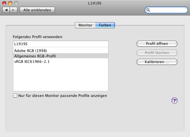

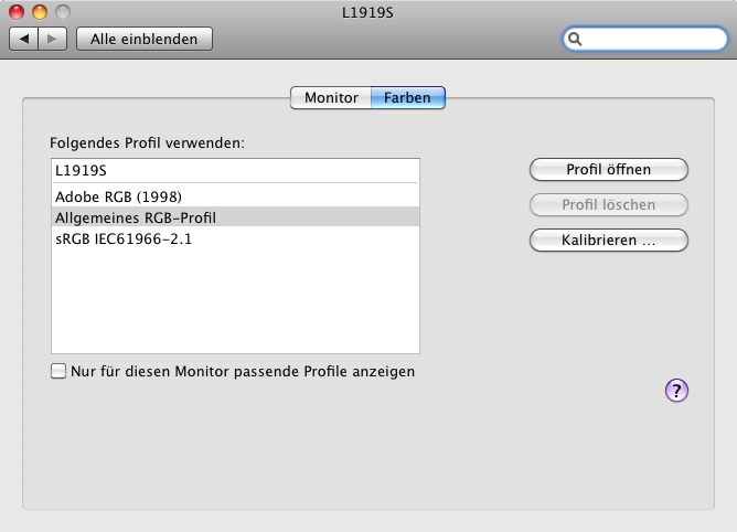

Same Problem here with a Mac Mini and a LG Flatron L1919S.
I kind of managed to solve it by switching my color profile to "Allgemeines RGB-Profil" ("General RGB Profile" in English, i guess...). The colours still aren't the same as with Leopard, but blue is now blue 😉
Btw, I did a clean install...
