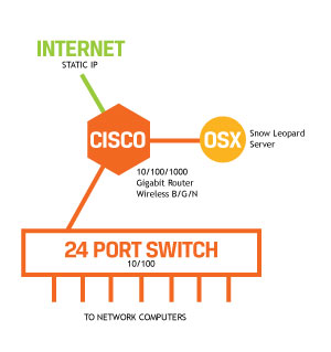

See my attached image for the basic diagram of my setup:
The website name (eg. mydomainname.com) forwards to the static IP address properly - I have tested the real domain name already and that's fine.
Now, when I try to set up my domain name on the SL Server it says it can't find the domain name as a fully qualified domain name (FQDN), and this bothers me, and I am thinking I have to do some other DNS stuff, but not sure what or where in the grand scheme of my network setup.
1. Router gets its Static IP from ISP provider (eg. 60.40.20.10)
2. Router acts like a firewall, and port forwards requests to SL Server
2. SL Server connects to Router and asks DHCP for IP (eg. 192.168.1.10)
3. Both the router and SL Server use the same DNS Server addresses provided by the ISP
I'm not sure if the DNS and the hostname and computer name have anything to do with this. maybe I should start a new thread or reply to one that's more related.
