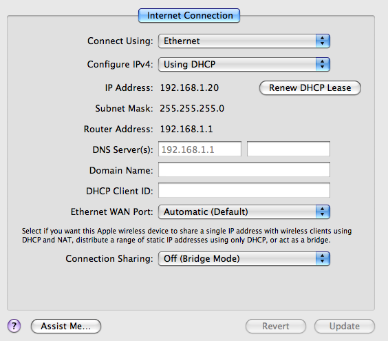

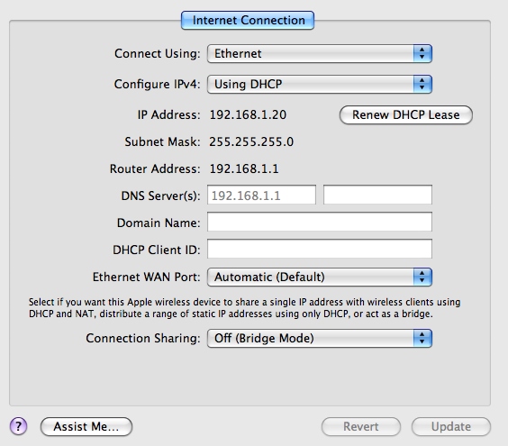

Couldn't find the DHCP reservations button ? I have my AEBS setup through a switch from the mail DSL Modem/Router , The main Airport Extreme(Time Capsule) base station is linked to several time Capsules via WDS. Here's a snap shot of the internet Tap of the TC setup page .
You are in "Bridged Mode" so it doesn't show.

What device are you bridging the airport with? Or better yet, what device is acting as your DHCP server? You would need to go to that device and setup the static IPs.
I will tell you that the IP of the device is 192.168.1.1 based on the screenshot you posted before. So if you have a Linksys router or maybe a DSL/Cable Modem that acts as a router, pop the 192.168.1.1 address into your browser and configure that device.
