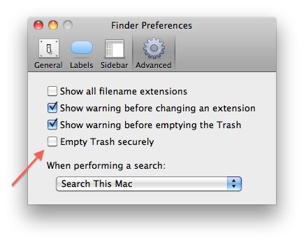

This is the solution to your problem.... Snow Leopard default is to secure empty the trash so you need to turn it off if you want quick trash emptying...
Yup--turning off "Empty Trash securely" should solve the problem.
