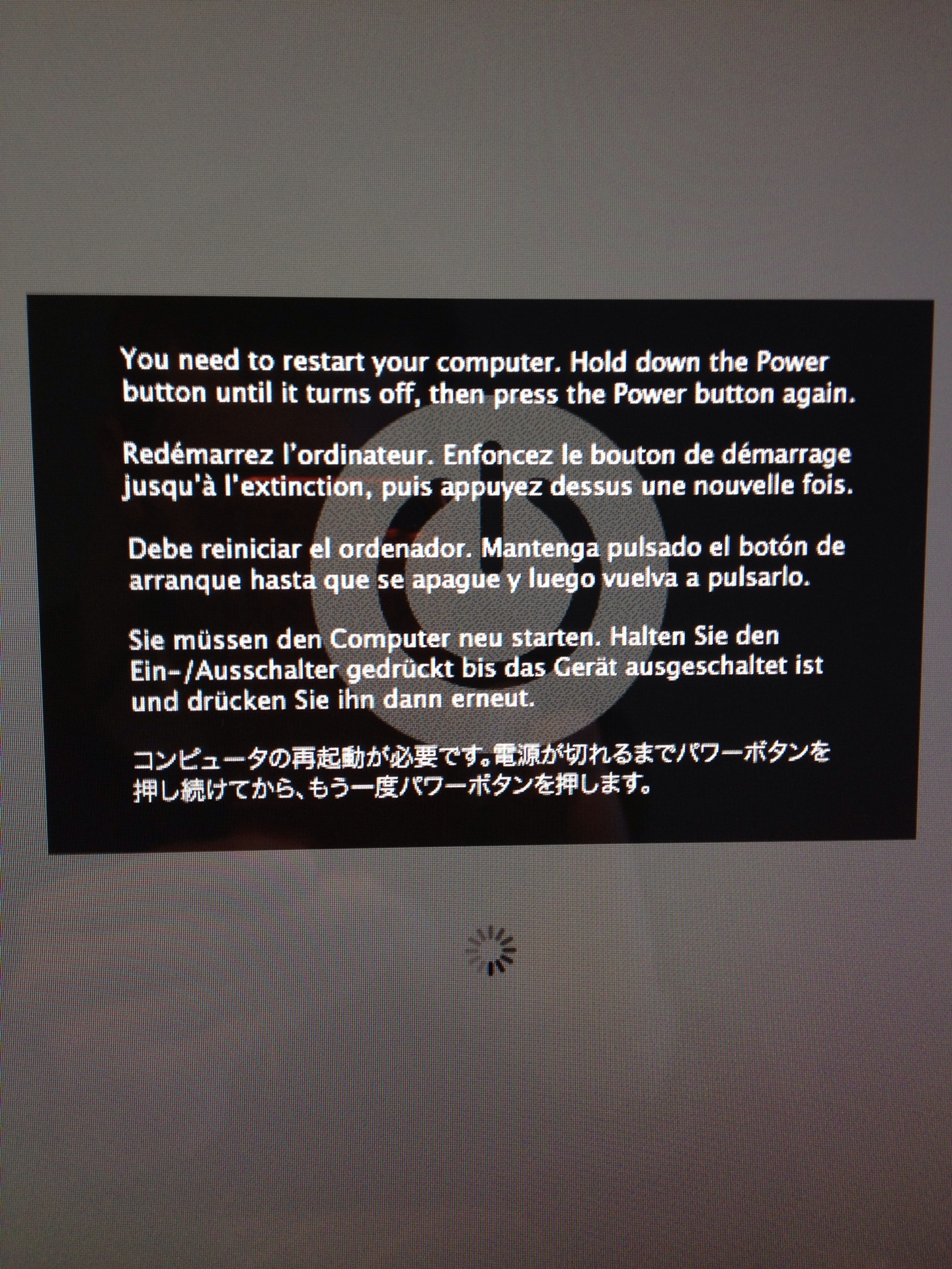

The hard drive on my 24" iMac died a few weeks ago, and I was able to get a new one installed (no Apple Care) on my own.
I inserted the OS X (Snow Leopard) DVD that came with the iMac, so I can install the OS. I hold down the "C" key when I press the power button (I've also tried holding down the Command key) and the iMac reads the CD for a few minutes, then the screen fades out to a dark gray, with the following message (see attached photo):
"You need to restart your computer. Hold down the power button until it turns off, then press the power button again."
I've gone though this process about 4 times, and each time the same error message displays on screen.
Any ideas what's going on here?
Thanks much in advance.
What kind of DVD do you have, the grey Restore or Upgrade/Retail DVD?
And when exactly did you buy the iMac?
Do you also have a backed up bootable Mac OS X clone on an external HDD?
Btw, did you make sure to reconnect all five cables after you connected the HDD?
Duff-Man says...yes, double check that you've got the drive connected properly and also check that while working inside the computer that the ram didn't get dislodged a bit - take it out and reseat it. Also, try disconnected any other peripherals you may have attached - printers, external drives etc etc and see if that's creating a problem...oh yeah!

Now that's odd! The kernel panic on boot problem can indicate a number of things are going wrong. FireWire (or Thunderbolt) target mode is one of the best ways to diagnose this... if the Mac's internal HDD/SSD is bootable and formatted. If it isn't, which is your case, the only solution I can think of, to try and figure out what's leading up to the crash, is this:
Rather than booting your Mac from the DVD directly, hold down Alt/Option on boot, so that the boot manager comes up. Select the DVD as normal, THEN try a Verbose Boot.

Last night I was able to format the new HDD and install Snow Leopard on my iMac after putting it in Target Mode with my dad's iMac. Installed the OS X via target mode. The installation went fine - I was able to get through the setup and see the desktop.
However, once I disconnected from Target Mode, and tried to startup my iMac on it's own volition - suddenly now my screen won't work. After the startup chime, the screen never turns on. This is now a new issue that wasn't a problem prior to installing the OS.
What fun! This iMac is only 3 years old and now it's useless.
