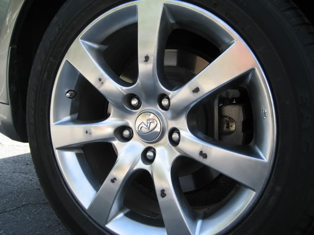

Your local parts stores, like Advance or Napa or Pep Boys, will stock tire cables in low volumes. They're, in a word, awful, and tend to cost alot of money for what they are. Their ability to ugly-up your rims is rivaled only by curbs.
One of my boys on G35driver had a typical poor experience with tire cables a week ago or so. Cables slip and cause abrasion on the wheel surface. Its very common.
His typical snow cable damage:
