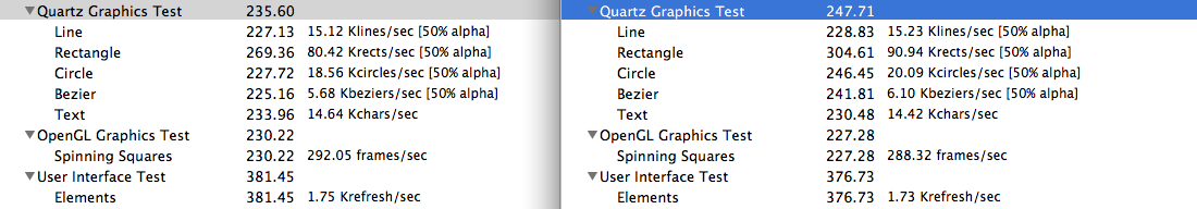

  13. avihappy thread starter macrumors 6502
    avihappy
    Joined:
    Nov 15, 2006
    #13
    No, performance is around the same:
    [​IMG]
    Left is new firmware, right is old firmware. The reason the scores may be slightly lower on the new firmware version is because I have installed new software since the old firmware test.

    It looks to me like the firmware update slowed it down, just a tad. The numbers are lower on the left that the right. Maybe its just that specific test, or maybe not. It would be interesting to see it run 3-4 more times and compare it then.
