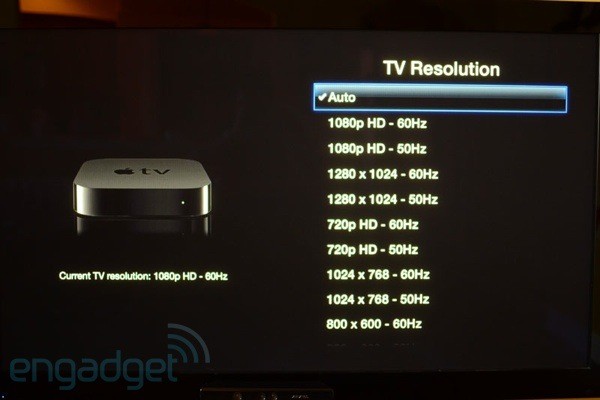

I wonder what it would do if you manually set Apple TV to output 1080p/50Hz. A lot of modern TVs can do both 50Hz and 60Hz, and 24fps to a multiple of 25 can be somewhat easier.

It's probably safer not to have a separate 24p option but instead simply incorporate it into the Auto setting. I recommend people fill out the feedback form on the Apple website to let Apple know we want this feature:

It would be even better if "Auto" tried to match the output refresh rate with the source framerate, but it doesn't -- it just switches permanently to the preferred refresh rate reported by the display.

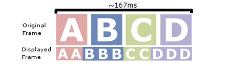

if it's outputting 60 frames, but the source is 23.976, each frame of the source lasts for 2 1/2 frames of the output. it's trying to make each frame match up that leads to problems.
http://en.wikipedia.org/wiki/Telecine#2:3_pulldown
has a good graphic that explains is.

anyway here is a picture that shows the 24p at 60hz problem -

You guys need to have a 120hz TV to be able to test 24p. Even if the ATV did support 24p but you had a 60hz TV, a pull down would be done. So make sure your TV can display true 24p when you report back.

You're right that a 60Hz display will get no benefit from 24Hz output, but it doesn't have to be 120Hz -- any multiple of 24 will do. Eg Pioneer plasmas have done 72Hz forever and in PAL regions there are quite a few 96Hz ones.
iTunes store content is mostly 23.976fps in my experience so 24Hz output would have made sense IMO. Most recent video SOCs have 1080p24 capability so there's a chance it might be enabled in a firmware update but because the ATV is basically an iPhone in a box, it might not have the same capabilities.
