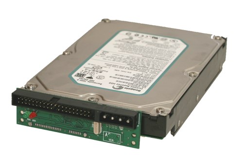

for harddrive,just use your sata drive with a sata to ide adaptor...should have room
1HoRpQNgFwux51HE.medium
$5.98 here..im sure can get all over
http://www.satacables.com/html/sata_to_ide_adapter.html
should work...only issue may be room...but if i rem my imac G4 had fair amount of extra room around drive area,as it's just placed ontop of cd/dvd...maybe best to take apart first to double check before you spend the $
