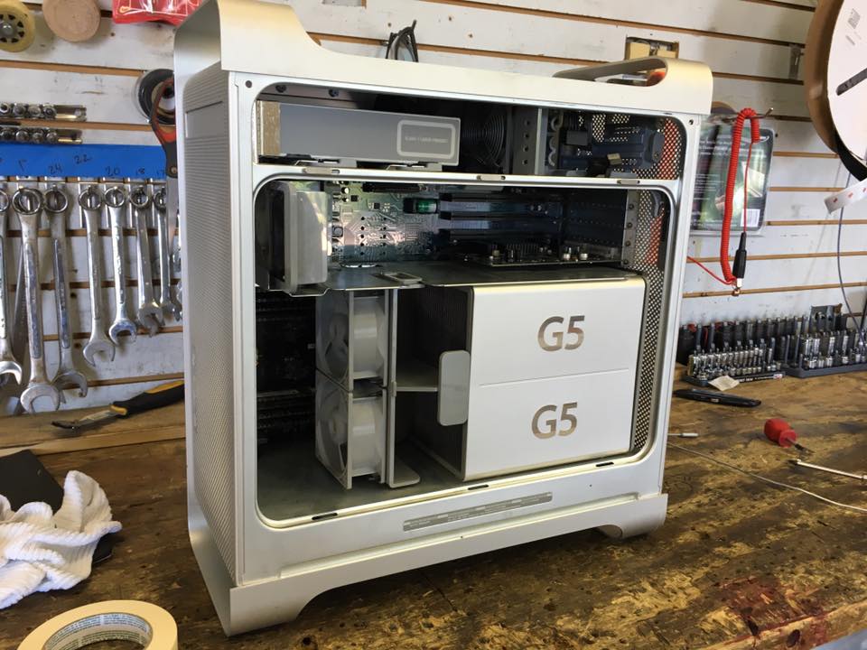

I scored this weekend, searched local Craigslist for "Macintosh Computer" and picked up an absolutely immaculate PowerMac G5 Dual for $10, along with it I got a 20" iMac G5, and a 1st Generation Intel iMac with iSight for completely free. But both of the iMac's aren't working, and the G5 keeps having a Kernel panic I'm wondering if you guys could help figure out.
Any common issues with these having Kernel panic issues? Heat isn't an issue, its very clean inside. I cleaned all of the contacts on the memory modules, and GPU with alcohol. It has a fresh install of 10.4 Tiger, just to test it. At the moment the only real issue I can notice, perhaps it was since I only had a few moments with the OS before it crashed, but it doesn't seem like all the memory modules are being noticed by the OS.

So quick update, set up my ram as required by Apple, which left me with two mis-matched sticks that I removed. After running for a good 30 minutes updating Tiger, it kernel panicked. I'll be loading Leopard tonight, since its just an all around better OS since its far more updated than Tiger, Tiger was all I had at the time. Checked the logic board for burst caps, and didn't really find anything. I'll update after the Leopard install.

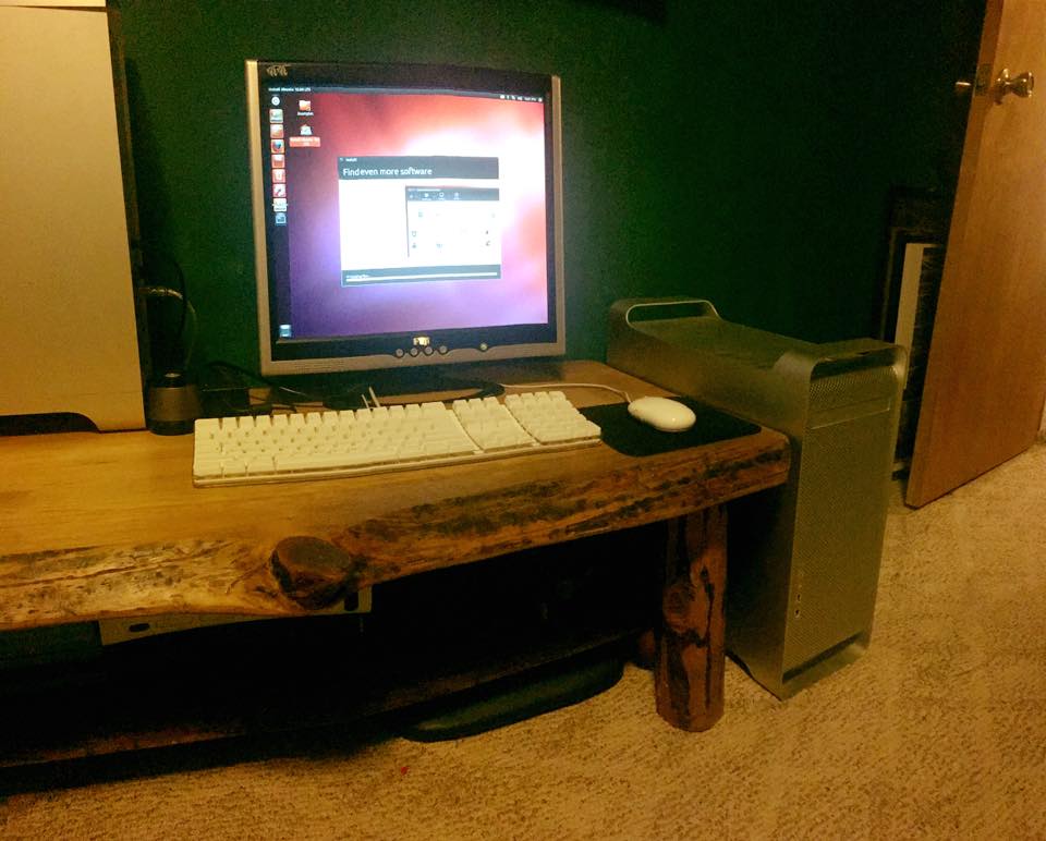

Tonight I loaded 12.04 Ubuntu on the G5, still full of errors. At the moment I'm running two 1GB sticks, and two 512MB sticks towards the middle slots. I took a closer look, and I had two 256mb sticks installed so I just outright removed those. Currently I'm trying to find a good copy/source of 10.5 Leopard to boot off of, since I don't have one among my collection.

Anyways, I loaded the G5 with an OEM copy of 10.3 Panther I had laying around. Stays running for a good hour or so before dying. Ran mem-test during the time that the machine runs, and all of my memory modules tested good. I currently have two four 512mb sticks towards the center, and two 1GB sticks towards the outsides, obviously taking up six memory slots.
Any solid way of testing the logic board (which looks completely fine, caps and all) or the power supply?
