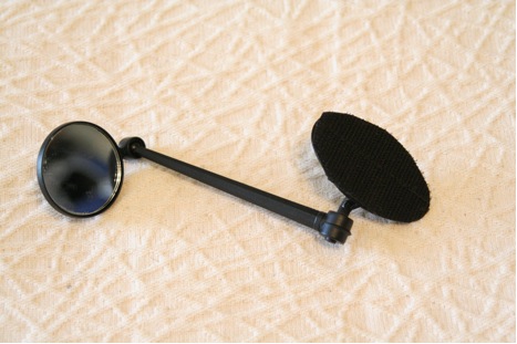

I could not help but laugh when i saw this thread title. I'm sure if my iMac had an SD card slot that close to the superdrive i would have put the card in there at least once. Should get one of those bicycle mirrors and mount it on the side of the machine so you can look at the mirror and see where you are putting the card.
and if its really stuck in there that bad a set of these: http://www.amazon.com/gp/product/B001PBQ9K8/ref=oh_o05_s01_i00_details
and a set of small torx drivers and you'll have it out pretty quickly.
