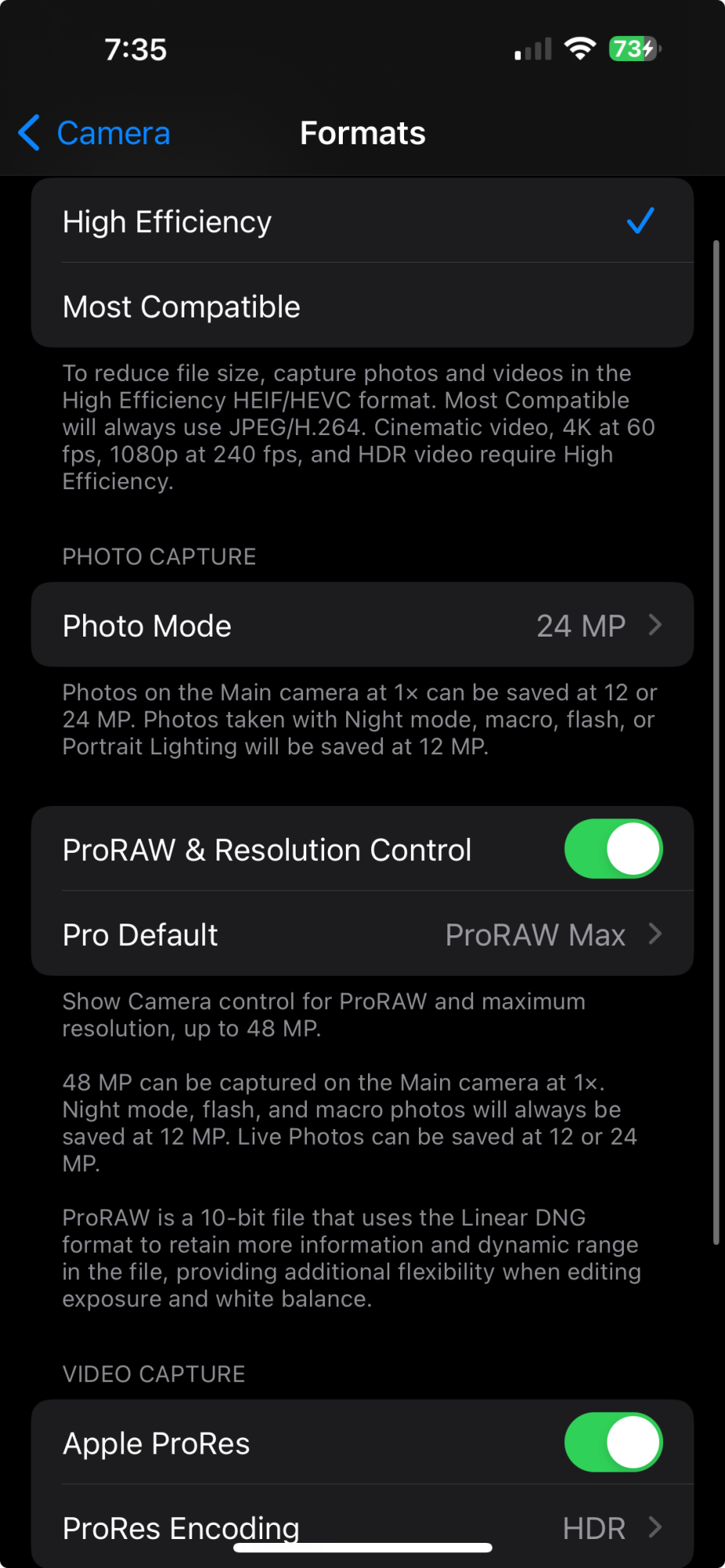

Settings fwiw:

Under settings it say 2 MB photo size for 12 MP, vs 3 MB for 24 MP. With such a small difference I see no reason to not go with 24 MP as the default. Keep in mind, even if you set it to 24 MP, there are many circumstances where the photo will still be 12 MP, depending on how the photo is taken - such as night mode, using zoom, etc. In other words, if you use certain settings or I think even change from the 24mm lens, it will go down to 12 MP. So again, I see little reason to not go with 24 MP as the default in my opinion.
I think I’m with you. The 24 MP only really goes to the 1X zoom and the file size difference isnt much so I’ll just stick with the default.
