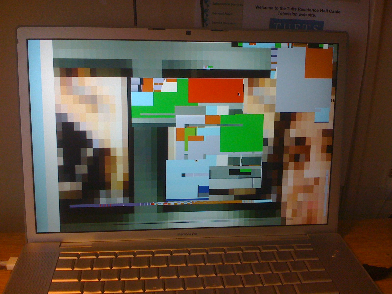

My MBP keeps having little fits where the screen gets all jumbled (see attachment). Usually it happens when waking from sleep, but sometimes it happens while I'm in the middle of using it. This is graphics card related, right? Dying card?

O occasionally get a screen similar to that - I think I've had it about 4 times in the last month. Was thinking it might be graphics related.
What rev MBP have you got?
Had exactly the same problem as you (I have the 8600GT card model (256mb). I had it sent it in last week for repair and the guy told me that this had never been reported... And then as I am waiting for the repair docs to be printed, I over hear some guy behind me reporting the exact same problem, but that it happens on a more frequent basis.
Got it back today - they replaced the logic board. Running fine at the moment, so get it in for repair before you run out of Apple care.

That was the first thing came to might when I saw the attachments. On a serious note, get your logic board replace cause it seems the GPU is at fault. Also, keep all paperwork for repairs if Apple or Nvidia fess up to the failing GPU.
Thanks for the replies! I have a 2.2 SR MBP. Guess I'll book an appointment and head over to the Genius Bar!

Try run your hardware test CD (came with your machine),
I had gfx problems a few times every week, and ran it.
I wrote down the error code, and called apple.
They arranged a mobo swap at my local dealer and a week later they swapped my mobo while I was at work and I picked up my MBP the same day!
