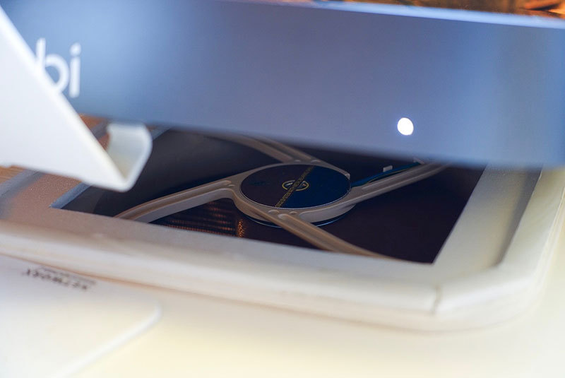

I had no real improvement with new thermal paste too (I have used Arctic MX-2).
But what it did for me (i7 Mac mini) was building a fan into a hole in the table below the Mac: My Glory Blow Hole.
That has improved the speed of the CPU because it now can hold higher GHz much longer and gives lower temperature for all components in the Mac like Wifi, SSD etc.
With Cinebench results of 1259 its performance is much higher than before (or compared to the Mac in this video). The single core performance was even the second highest in Geekbench ever recorded for a Mac. And it was even not much louder than before: The 14cm fan below the Mac is less annoying compared to the much smaller built in fan on high load. Only on low temperature the new fan is louder.
Later I've improved it by programming a small background app that controls the fan speed over WiFi depending on the temperature of the CPU (via a self-programmed ESP8266 with PWM). It works really good.
I have put some documentation and the links to the project files (XCode and Arduino) to this thread on egpu.io: https://egpu.io/forums/gpu-monitor-...-thermal-solutions-thread/paged/2/#post-49475

Could anybody test how much Performance increase you get when you Turn around the mac with Open case? The 140mm Fan mod is interesting but no Reason for me. An Open case on the bottem with a beautiful stand or a modified cap witch lift Up the mac so that fresh air could come inside, would be nice.
Don‘t try it. you will be surprised. Get 400MHz higher frequency (i7) on all cores at Full load only for Open the Plastic WITHOUT removing the Grid. It is louder at fullspeed but ok for me. Where can I buy a Custom socket. Akitio , OWC... come on 😉 the Solution with the big Fan is ugly, sorry.
