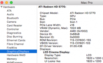

These were the lowest powered GPU'S supporting Metal:
  • ATI Radeon HD 5770 from Mac Pro (Mid 2012)
  • NVIDIA GeForce GT 640M (aka: GK107 N13P-LP) from iMac (21-inch, Late 2012
I have HD5770 but I can't even run Fortnite as it says I need Metal Supported graphic.
