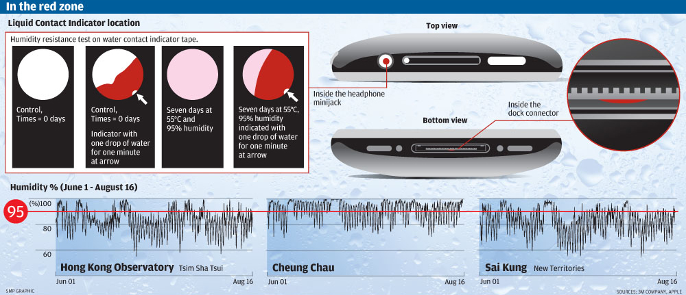

Remember these? They used to be the bane of every Genius Bar appointment-holder's existence:
The locations of these moisture sensors were well know for just about every iPhone up to the 4S, but I can't find them in the 5. Surely, Apple still wants a quick way for their techs to know when an iPhone has legitimately "just stopped working," and when it stopped because it took a dunk in the drink.
Anyone know where they might be hiding?
