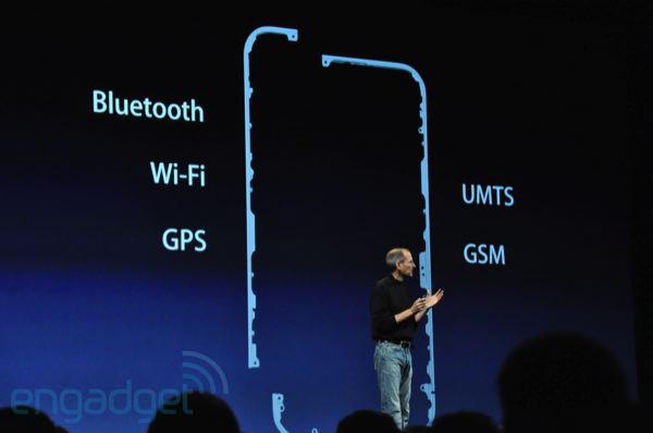

One antenna goes from the death grip seam, up to the headphone jack. The other one goes from the death grip seam, through the dock connector, all the way up the right side, and to above the front camera. I thought everyone knew this.

The sideband isn't all one antenna...
The sideband consists of various antennas: 3g, wifi, bluetooth, gps, etc. Most are separated using the seams, though the seam on the right is just for looks, to keep it symmetrical. Just google and look for an image of the antenna, during the wwdc, jobs showed a slide with the antenna and the various parts of it and what part was for what. The one on the left is for 3g which is why when you do that, it screws with the signal.
The one on the right is not just for looks. That's the Wifi antenna. :apple:
Not true, the surrounding metal band forms the antennas, and the black lines separate these antennas. You can see in the photo below that the top and left side lines separate the two antennas, and that the right side line doesn't appear to serve any function.
