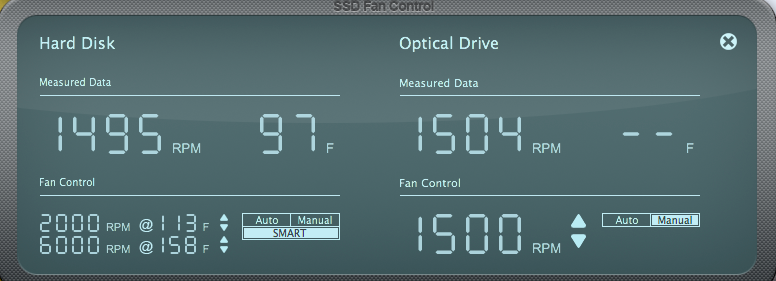

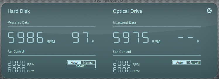

Persistent high speed fan fixed
Oh my god .....blessed silence. The fans were running at top speed...6000 RPM The mac genius bar had no suggestions except to replace computer or logic board. SMC was reset to no avail. I suggest you use the SMART SETTING when the computer heats up.....the fan comes on.
without SSD fan control
Mac OS X 10.6.8 Macbook Pro 2008
http://imgur.com/V12Qyzt
with it
http://imgur.com/FGDIihj

However from the attached images you can see that the high speed fan setting is independent of the temperature and comes on as soon as cold computer is turned on. Hence my conclusion that it is not a sensor problem but the execution of the logic board interpreting the sensor and creating an action.
A theory is (mine) is that the logic board has a default action as
fan on high if problems with sensor input or confused inputs
this would be a much better default action than
senor input issue......default to fan off
Here is the image of the temp and fan speed from a wake up from sleep mode showing cold sensors all around and high speed fan.
http://imgur.com/F1zLtFC
the image is also attached
