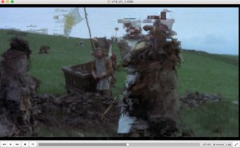

I tried this however I am not seeing any difference (MacBook pro with Sierra and VLC 2.2.6). I tried your method and the one on Macworld. Am I missing something here? Was I supposed to use the link in terminal exactly as you posted or was I supposed to add anything? See screenshot. DVD plays fine in Mac DVD Player app just no good in VLC and Handbrake.

In 10.11 El Capitan and newer, you need to have SIP turned off in order to do anything with the *nix folder structure. So, you would need to either launch into System Restore mode and execute the copy in Terminal from there, or disable it entirely using this guide.
Just type the command exactly as it shows. The fact that it's ripped at all suggests that you've executed the command correctly and it could be something else (not sure what) that's causing that corruption

That's not true from my experience - I've never turned off SIP and handbrake works fine for me after copying that .dylib into /usr/local/lib
I had exactly the same issue before I installed libdvdcss.2.dylib so nothing has changed. Any other ideas?
