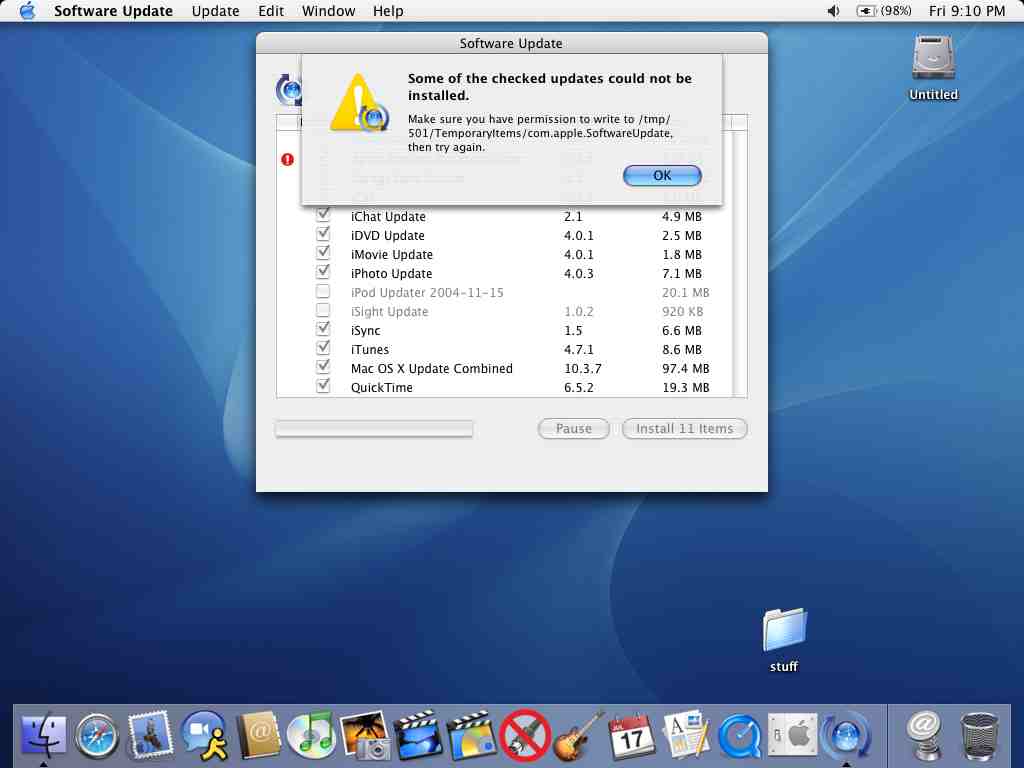

How do i fix this so I can install updates on my comp 😕

Sounds like it may be a dead permission.
EDIT: You could also just download the stand-alone updates from apple.com
Open Disk Utility and do a Repair Permissions on your hard drive, then try Software Update again. Let us know if it works or not

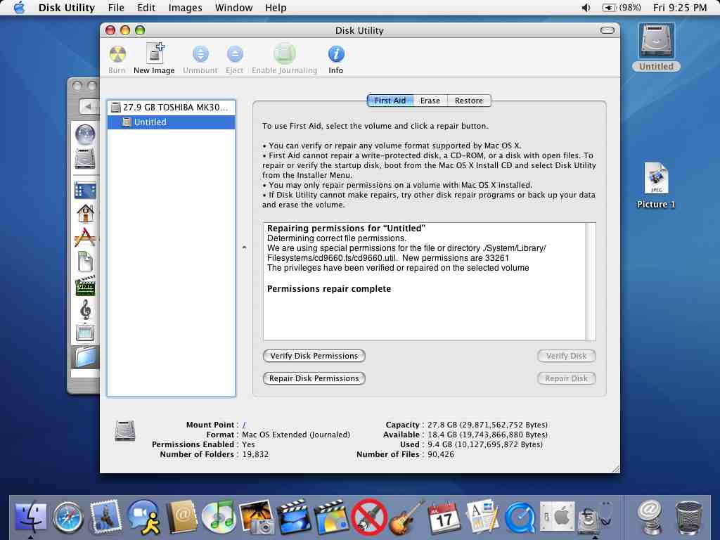

it doesn't work, i hit repaird permissions and i still get the same thing.. im perplexed.. 😕
k heres what it says from disk utility, im gonna try the individual updates now.

one thing you could try doing is directly addressing the error and changing permissions on that one file. open up a terminal window and type (w/o the percent sign):
% sudo chmod 644 /tmp/501/TemporaryItems/com.apple.SoftwareUpdate
you'll be prompted for your password. if that doesn't do the trick, try it again, only use 755 instead of 644 (i.e. i assume com.apple.SoftwareUpdate is a file, but it may be a directory, and that needs the execution bits set, which is what the 755 does [among other things]).
report back on if it works. if the sudo command gets you an error, cut and paste both your command and the error message here for debugging.
That file shouldn't exist, so you'll probably need to set write permissions on its parent directory.
i still get that same error, i did that thing in terminal and it says no file existed.. the irony of this is i reinstalled os x twice! and im still getting that error, fully formatting the drive as well.
damn.. all i can say is wow, this isn't working for me, i tried the unix command anybody else got any other ideas?
