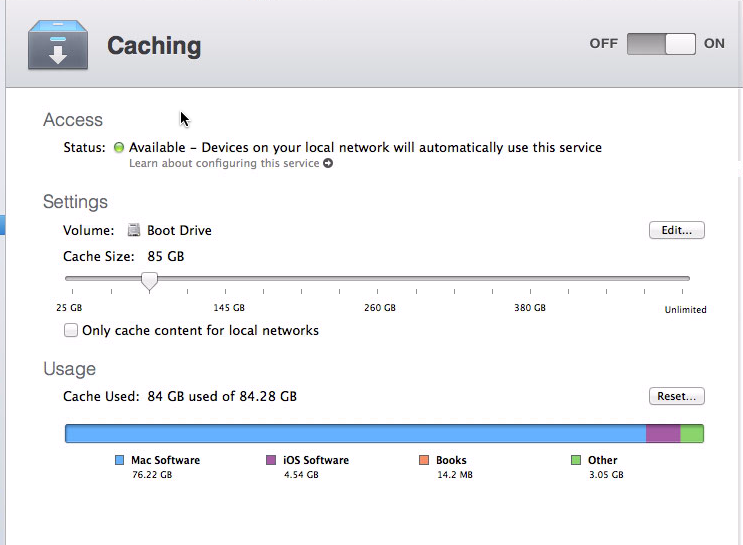

You can't but it doesn't matter since it caches every update. You do get an indication of how much disk space is being used and what category of update is taking that space.
You can see from the attachment and that I've got 7 Macs and 4 iOS devices to update that having this service has saved me hundreds of gigabytes of downloading. It's quite something to tell it to update something huge (like Xcode at over a gigabyte, or a new OS X release) and having it "download" in 10 seconds or less.
