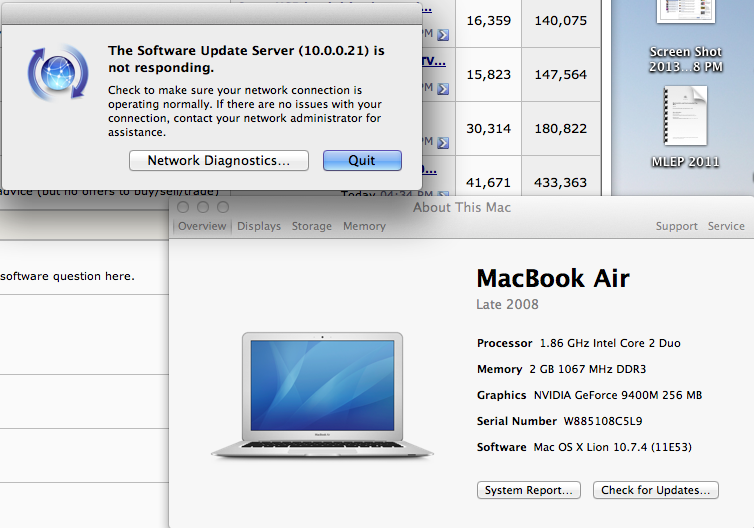

So my late 2008 Macbook Air that has been struggling, but just managing to run Lion has been having some trouble updating??
Every time I request the Software Update to open, it brings up and error message stating Server (10.0.0.21) or (10.0.0.2) is not responding! I am always connected to the internet and everything else is working, so I cannot understand why the software update is not connecting? 😕
I have uploaded the screen shots of the messages.
If anyone has any thoughts/suggestions on this matter I would love to hear. Also whether I should maybe just put Snow Leopard back on instead..?
Thankyou!
Kate

Are u using 10.0.0.x addressing as your Intranet IP? If so u may have configured some kind of proxy that u shouldn't have.
Hmm I went through all my network advanced settings to check that because I did have some proxies set up in the past but none were set up. Hence I am so befuddled!
As stated in the previous post software update is pointing at an internal IP address. Do you use the MBA at work?

Hi there, no I don't - but I opened the file that it directed me to and it has the following content:
bplist00Ÿ
  _AutomaticDownload_LastAttemptSystemVersion_LastRecommendedUpdatesAvailable_RecommendedUpdatesZCatalogURL^LastResultCode_LastUpdatesAvailable_LastAttemptDate_LastSuccessfulDate ^10.7.4 (11E53)£”ZIdentifier_Display Version\Display NameX041-3000S2.9_HP Printer Software Update”X041-2996U5.1.1]Keynote 5.1.1”_MacOSXUpd10.7.4V10.7.4_Mac OS X Update_%http://10.0.0.21:8088/index.sucatalogd3A∂”T/3Aµª/JlÅåõ≤ƒŸ⁄ÈÎԈ )-JQZ`nuá醻*”!‹
I am vaguely challenged when it comes to codes so does thet mean I need to delete the selection marked in bold and replace it with http://softwareupdate.apple.com?
Software update is definitely pointing at that IP address.
The public apple software update servers are located as follows:
http://swscan.apple.com
http://swquery.apple.com
http://swdownload.apple.com
http://swcdn.apple.com
The latter (http://swcdn.apple.com) currently redirects to the Akamai content distribution network that hosts the updates
However, I would try renaming the com.apple.SoftwareUpdate.plist file and then start software update again.
