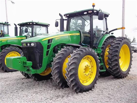

Friction, it makes things less fuel efficient because it gets too grippy. Think of people driving pickup trucks with giant knobby tires, they get far less mileage simply because there is more friction. Asphalt itself has a huge range in friction coefficients tied to the particular use case.

1. The pickup truck. Not exactly very fuel efficient
2. If you are talking about larger non-stock tires, wouldn't the truck have to produce more torque to overcome the added weight of the tire and the difference in diameter from stock, thus consuming more fuel?

As for the pickup truck, I was referring to if you take the same exact truck. If you use the normal tires it gets better fuel mileage than if you stick the off-roading knobby tires on it. It's a function of friction.
