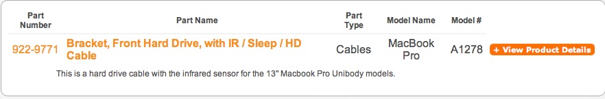

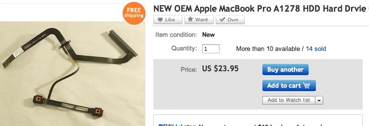

I ordered a cable through eBay. They are half the price of iFixit and have a 30 day return policy.
I sourced through a seller in NY to save time, but there are ones from Asia for a few bucks less.
There are two choices - with or without the IR/Sleep Light and bracket connected. I chose with, because looking at mine, I just can't tell if I can safely remove mine and reuse it. The way they are joined is very tiny and intricate - so not worth the risk or hassle to save less than 5 bucks.
You can see the bracket that the HDD connects to in the bottom of this screenshot - it contains the sensor and light.
The second screen shot describes that part separately. So this is two distinct part #s preassembled to each other. Hope this helps someone else in the future.
