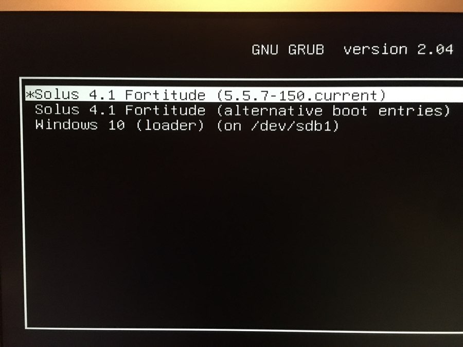

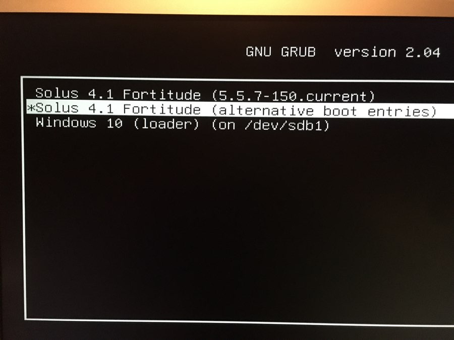

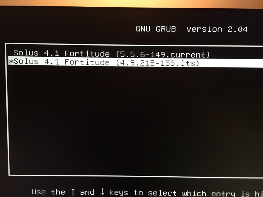

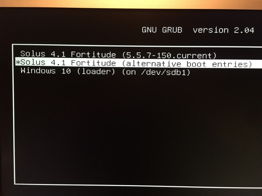

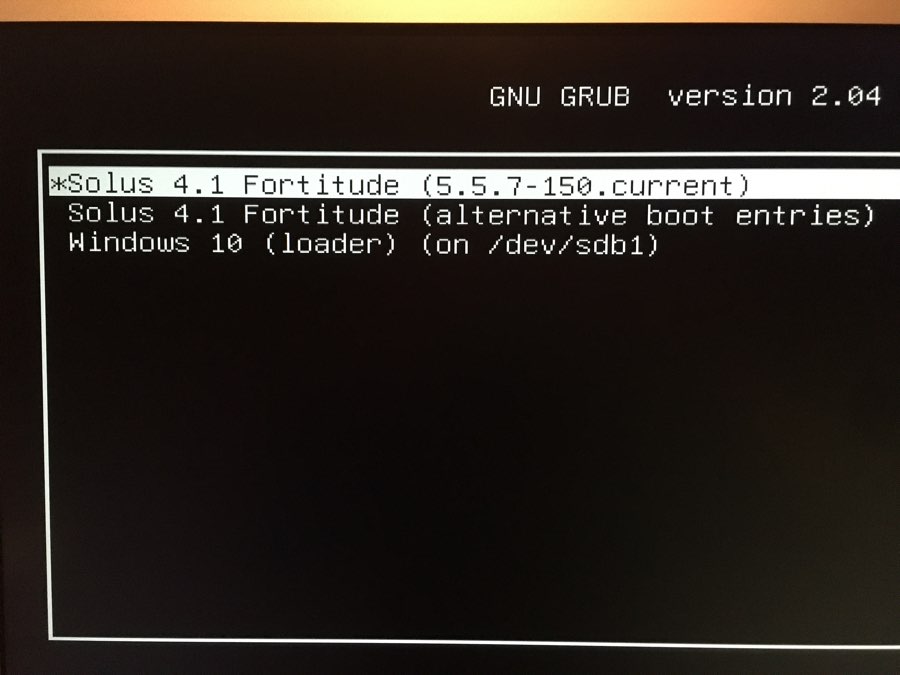

Just a couple of issues regarding these ‘modified’ ISOs on the Mac Pro 1,1
- If I choose to reboot the Mac Pro it goes to an infinity loop of reboot, it shuts down and boots as should but then it doesn’t even try to boot, it shutdowns and boots again. So I always choose shutdown instead of reboot.

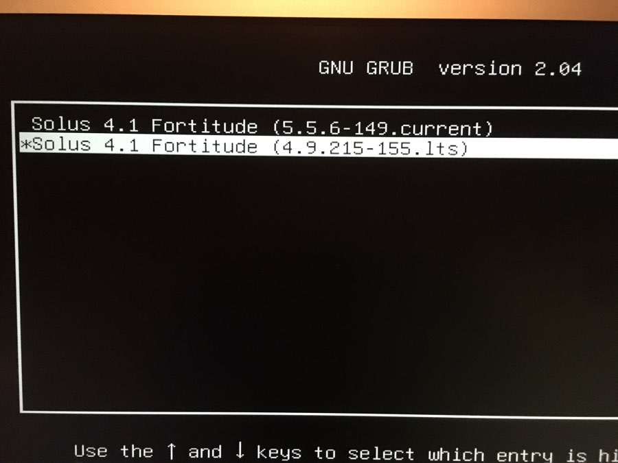

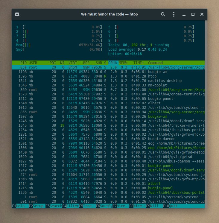

- There was an issue on the latest linux kernel that made the CPUs heavily used, I have seen over 1000% (!) Recent updates seems to solve that, users claiming Solus flies again. But you can install the LTS kernel on Solus (look for it on the software update section) and choose it on the GRUB menu under (alternative boot entries) In that menu you may see also macOS as boot option but as I blessed the Solus HD is not shown on the Mac Pro actually. Anyway booting with Option key gives you all the options.

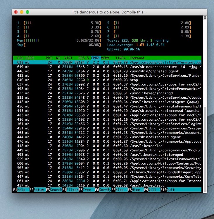

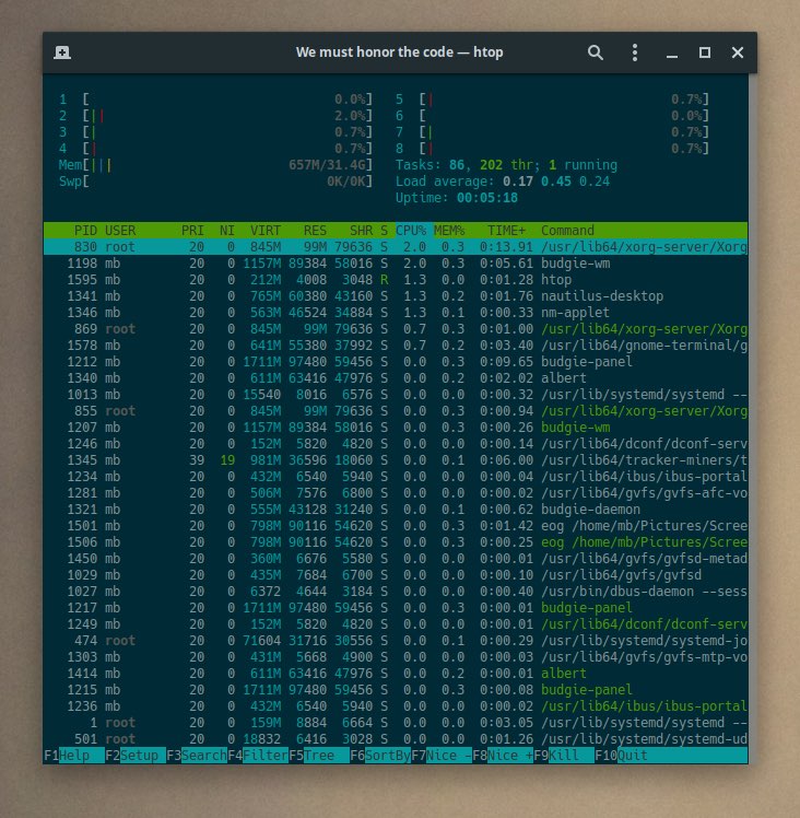

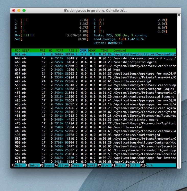

Also check the memory use of macOS and Solus after clean boot. Not to worry on my 8-core 32GB Mac Pro but..
