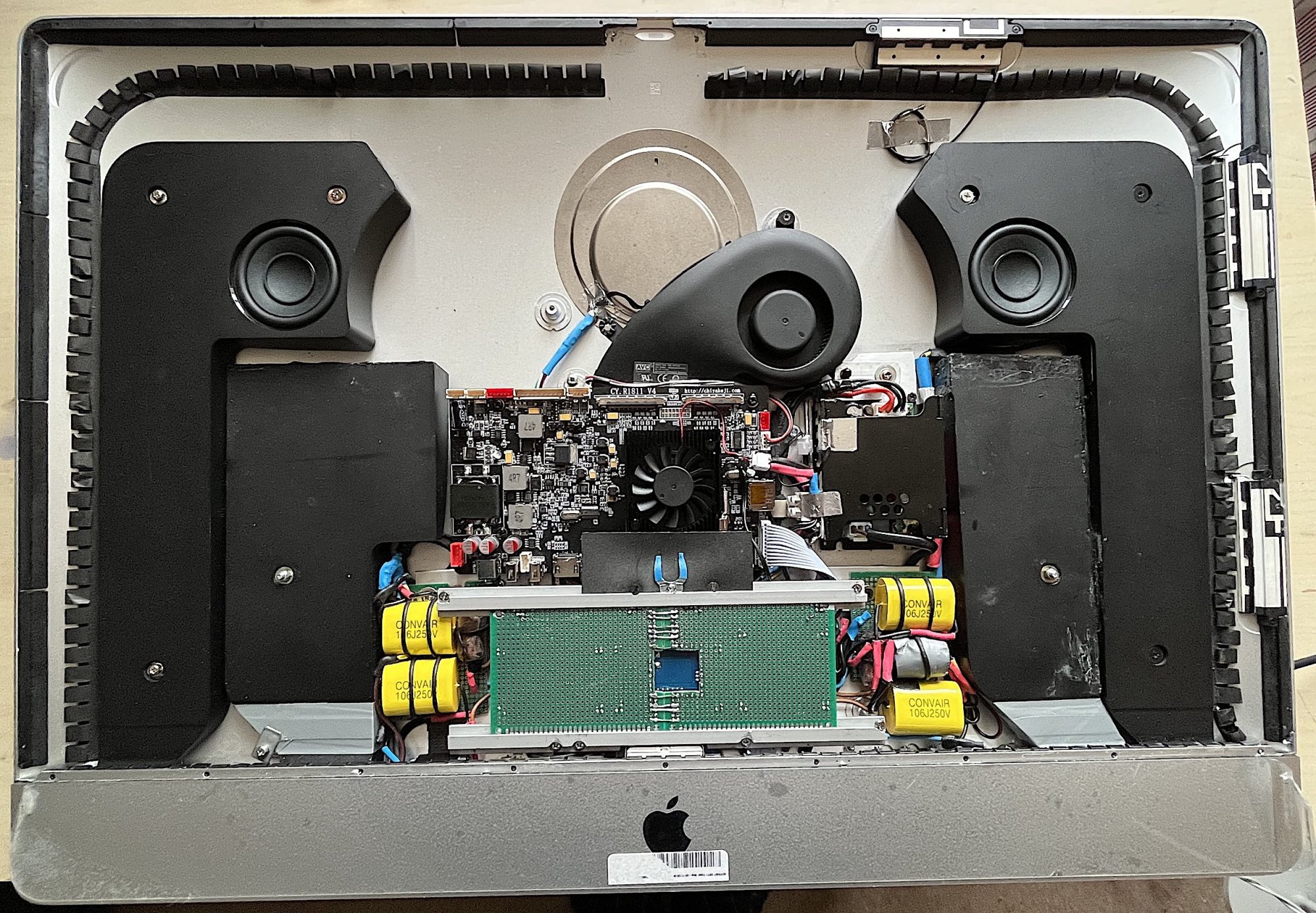

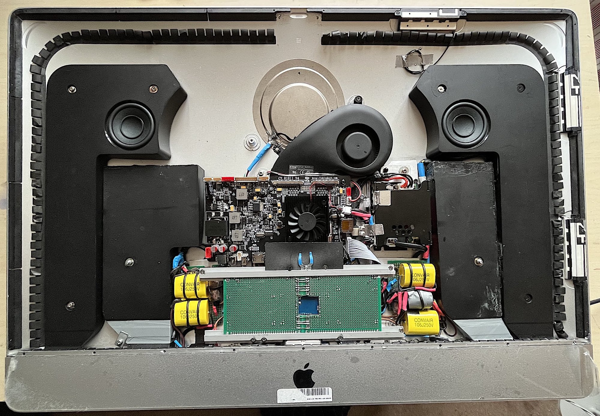

It is possible to convert an iMac 27" 5K model into a monitor. This requires opening the imac, ripping out the hardware motherboard and PSU etc, and install a Conversion board so you can use it as a monitor. I might do this in the future myself. There is a youtube video that show you how it's done.
One of the downsides of this approach is that they don't have a standard fix for the speakers at this time. I have heard of people trying to get the speakers working but I don't know how successful they've been.

"It is possible to convert an iMac 27" 5K model into a monitor."
@LukeMiani didn't show a 'real world' conversion, he made a quick double-sided sticky tape proof of concept YT video.
For the real world experience of how it's done visit the MR forum DIY 5K Monitor Success. 🙂
@pshufd "One of the downsides of this approach is that they don't have a standard fix for the speakers at this time. I have heard of people trying to get the speakers working but I don't know how successful they've been."
Very successful. 😉
Its easily done with a plug'n'play solution from AliExpress.
Or you can do it properly - which is not so easy but gives my 'very successful' result.
