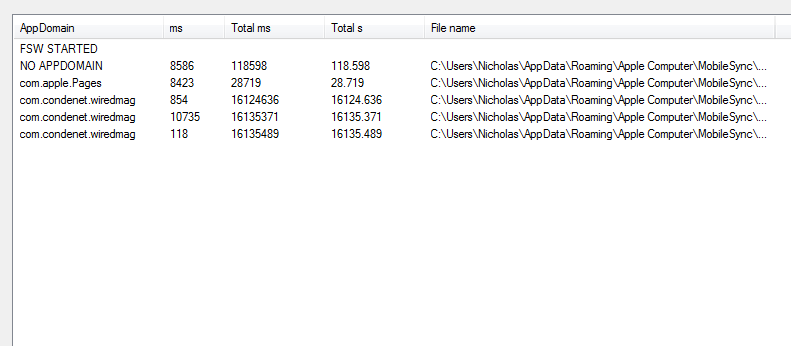

Damn, looks like my PITA app is Wired... Two issues (June and August 2010) and the bonus free issue and it's taken 4.482 hours so far. Oh yeah, and my backup bar is about 50% done/full.
