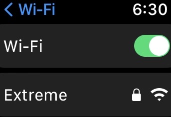

I have my 2.4 and 5GHz bands named separately. Always have since we have some devices, a printer, and our series 5 watches that can only use the 2.4 band. We have our phones and iPads, Apple TV, Sony tv, and a soundbar connected to the 5 band. The stationary devices - tv and soundbar - aren’t a problem but the phones and iPads come and go. So if we’re out of the house they would latch onto the 2.4 band when we come home since it has much greater range. We just had them “forget” that network so that they always connect to the 5 which is significantly faster. Our router on the 5 band pretty much covers our whole home so this is the best set up for us, and also allows me to see which band a device is connected to if there is a problem that might be related to WiFi. Naming both bands the same which our router allows under a unified network, lets the devices pick up the less effective band which we don’t want.
Under WiFi on your watch you should see available networks, our series 5s only see our 2.4 so nothing I can do with that, only 2.4 is going to be listed. Your Ultra supposedly can “see” 5GHz bands and connect to them. I‘ll be getting mine soon so I’ll find out. But on yours can you take a photo of the networks that show up on the watch? Your 5 band should be listed if you have them named separately, if not you’ll only see the one name which can get confusing, which is why I name ours separately. In my screenshot below you’ll see Extreme. That’s our 2.4 band and the only one that displays on the series 5. Hopefully with the Ultra there both our bands will be listed.

It doesn’t have to. In my situation my phone is always connected to the 5GHz band of my WiFi network, my watch cannot connect to that so uses the 2.4 band. It’s all one network but I have the bands named separately. On the WiFi setting screen of my watch, that screenshot above from the watch, only shows my 2.4 band which it is connected to. Now @Bacasable should be able to manually connect his watch, the Ultra, to his 5 band if he can find it on his watch. If his phone is already connected to it he may not have to.
But his question seemed to imply that he has the bands named separately, and that the 5 band doesn’t appear on his watch, and it is not connecting to it. At least that’s how I’m interpreting what he was saying.
