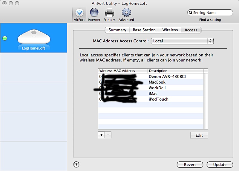

b) I got a Denon hi level A/V receiver (the 4308CI) 6 months ago and it has wireless capability. At one time I may have entered the MAC address into the wireless settings (and my other computers), if so, that is why I can see the network but not connect. So, if MAC is enabled either turn it 100% off - or - for "best" security leave it on and enter the iPod Touch MAC address.

Problem SOLVED!!!!
Way back in February I started using MAC addressing, because I was worried my Denon A/V might somehow open a hole for hackers, and forgot all about it until speaking with the "Genius" at the apple store
So, I entered the iPod info there and presto, hook up!!
