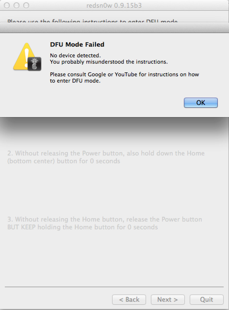

Thanks for the replies, I have downloaded IPSW 6.0 and redsn0w. But every time I try to use recovery fix or select IPSW and follow the instructions, the phone keeps turning on when it's supposed to stay turned off and I get the attached error message
You don't need to enter dfu mode to select ipsw
Run redsn0w
Extras
Select ipsw
Choose iOS 6.0
Go back
Jailbreak
Check hacktivate and install cydia
Put phone into DFU mode (the screen will be completely black)
The process will run and it should be tether jailbroken afterwards
Install p0sixspwn from cydia and it'll untether the device
If you're getting exploit failed or something, do a clean dfu restore to 6.1.3 and then try again

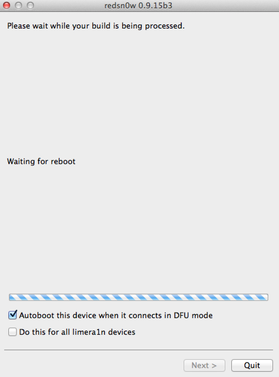

Aha! Got the iPhone jailbroken with redsn0w and it's running now, however I don't see any Cydia app, tried to reboot the phone, but it's still not there...
And when I try to reboot it using redsn0w like it advices me to do, the phone never reboots...
Yes, that's what I was saying. Redsn0w hacktivates your 3GS
Make sure to select the 6.0 ipsw before you use redsn0w's just boot
To untether your device, install p0sixspwn after jailbreaking (I assume you're jailbroken if you need to use redsn0w to boot up your device)
