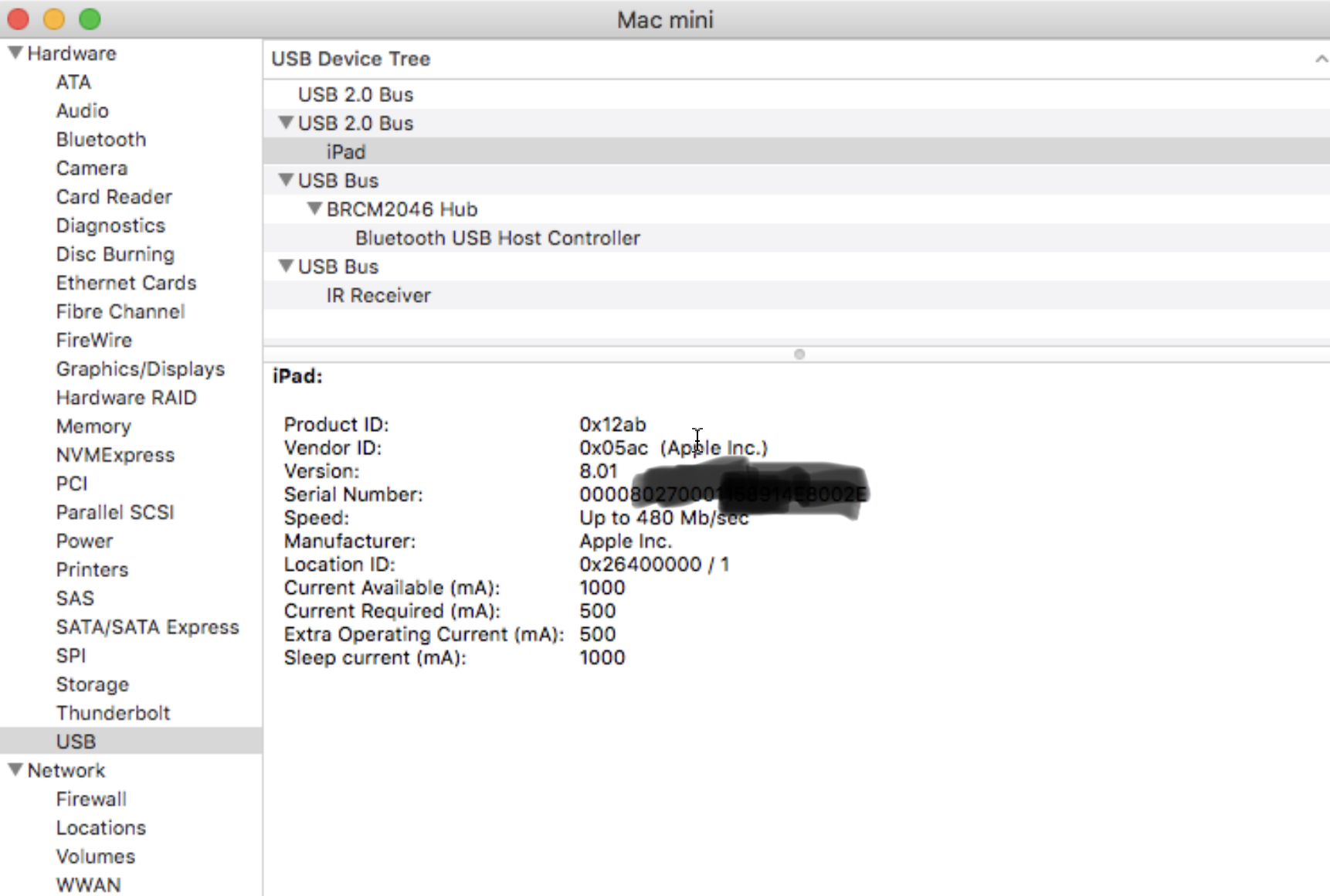

Probably a niche problem, but I can’t get iTunes to recognise my new iPad Pro.
When it’s connected to my USB-A-to-C cable, the Photos app opens on the Mac, so the Pro is being recognised. Also, in System Report the iPad is shown as connected (see attached pic).
But still nothing is picked up by iTunes.
I’ve tried restarting both devices multiple times, but still iTunes doesn’t mount the new iPad.
Anyone here had better luck with connecting to iTunes on a USB-A-to-C cable?

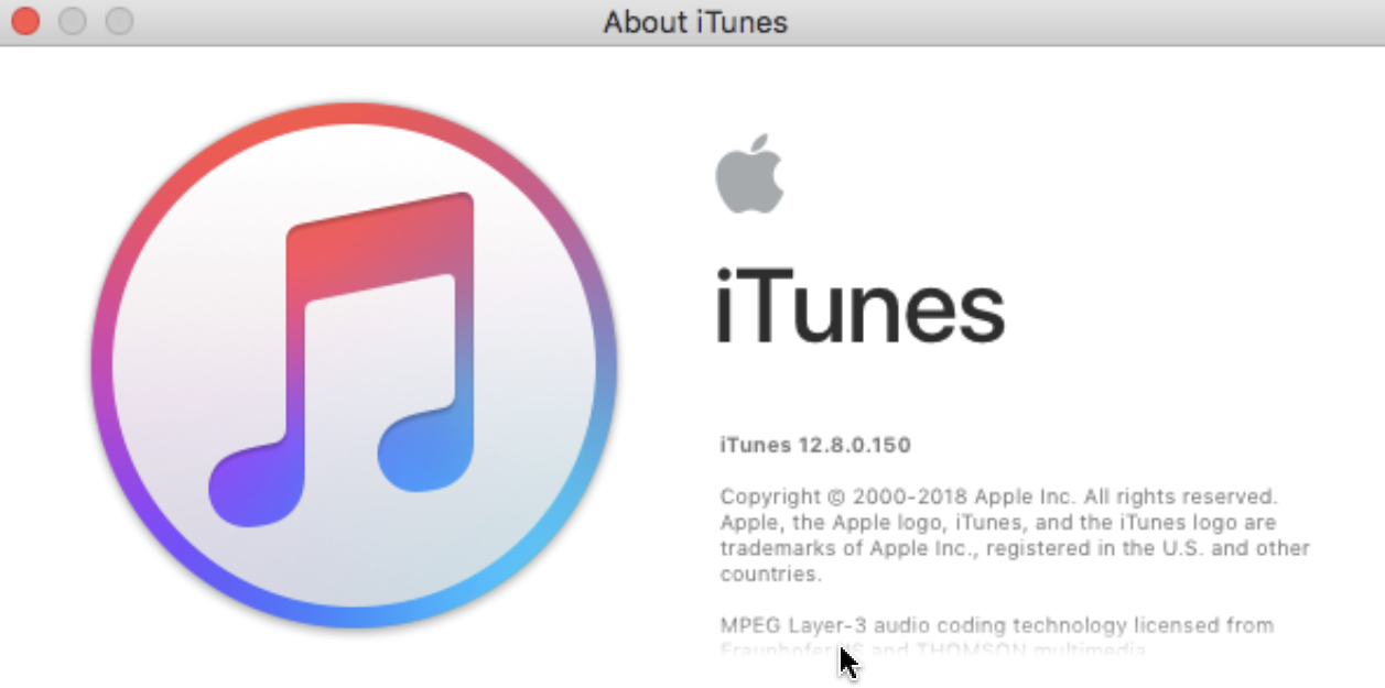

iTunes version 12.8.0.150.
Software Update tells me all software is up to date...

You might need 12.9. What does it say on the back of the iPad Pro box for minimum software required?
It says iTunes 12.5 or greater here: https://www.apple.com/lae/ipad-pro/specs/

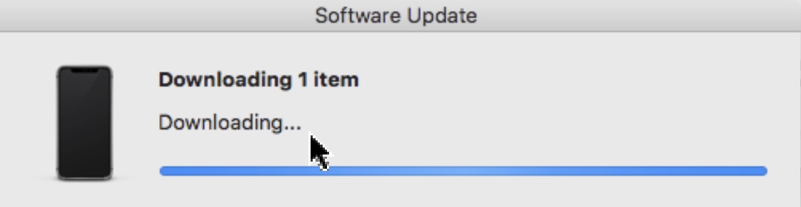

Update: I plugged the Pro into my MBP instead of the Mini and was prompted that a software update needs to be run.
Went back to the Mini and found the same window had appeared on connection, but UNDERNEATH the iTunes window, so I missed it. Fat lot of use!
Now downloading this update, it’s taking a while...
Yup it will automatically prompt the revised version for new devices.

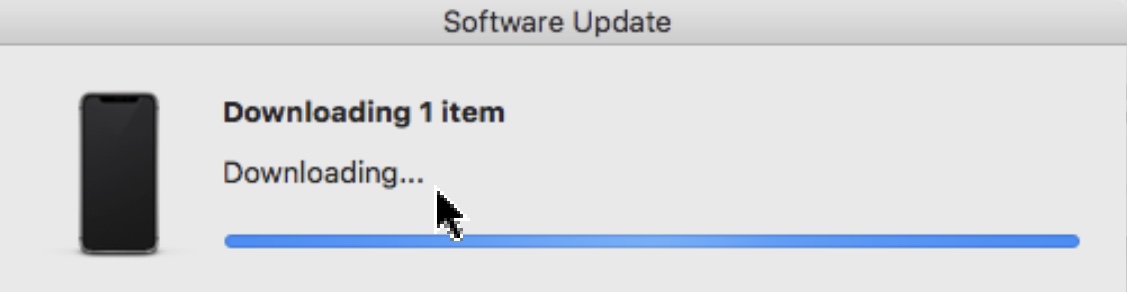

After installing the hidden software update I mentioned above, I’ve now successfully set up my new Pro from my 10.5 Pro’s backup.
Note my Mini is running El Capitan, so there’s apparently no restriction to Mojave for USB-A-to-C cable connections.
