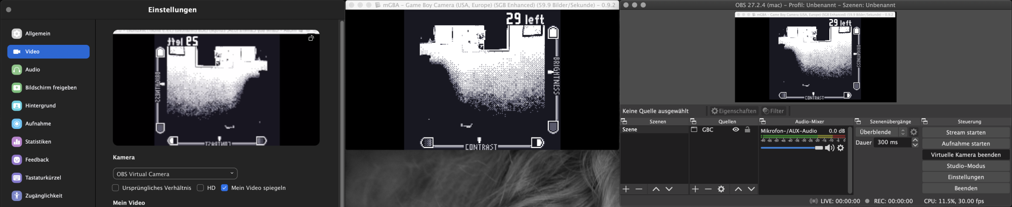

I've just tried this “the proper way”. I loaded a Gameboy Camera ROM in mGBA, told it to tap into my Mac's webcam and made OBS use its window as a virtual webcam. It initially worked in Photo Booth, Skype and Zoom but for some reason stopped working in Photo Booth and Skype.

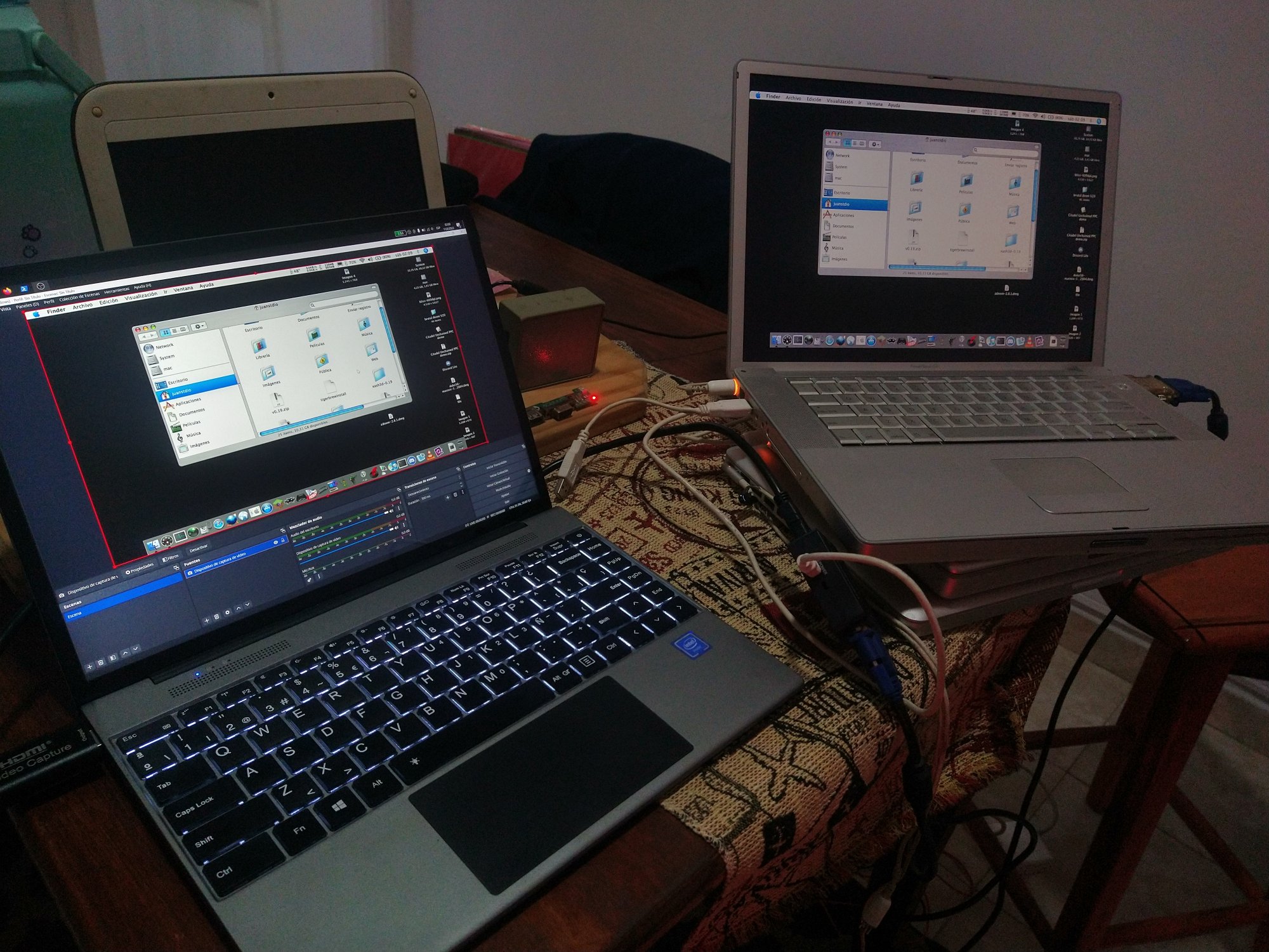

These was one of my first problems and I solved them using this simple "method":
Every G4 15" has a DVI output so I started using an DVI to VGA adaptor and "mirrored" the output of the main screen.
then using a VGA2HDMI Cheap converter I got the signal "converted",( I was able to achive 720p@85hz using that cheap adapter, totally recommended). Then I used a small capture device and hooked up to the streaming PC, with OBS I created a scene and used the signal from the USB capture card and displayed it with almost 0 Lag, totally recommeded.
Audio was captured by the VGA2HDMI adapter and included in the HDMI signal 🙂

here is the setup that I used with those components, note that the screen of the G4 15" was adapted to 16:9 ratio (and gave some extra FPS to some games!)

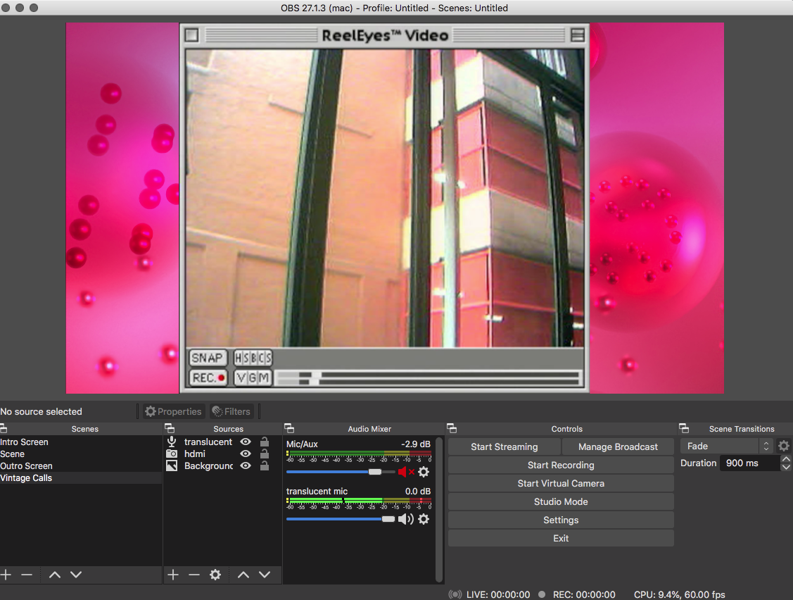

Ok, project update: success! I got my vintage OS 9 webcam and PlainTalk headset to both communicate with a Mac Pro 5,1, feeding an audio and video stream into OBS, which can then be used to make a recording, or to do a video call.
The setup was simpler than I originally anticipated:
1) Power Mac G4 with USB 1.1 webcam and Plaintalk headset microphone jack connected.
2) VGA cable from G4 to mini VGA2HDMI adapter (powered by USB)
3) HDMI cable from VGA2HDMI adapter to HDMI USB Capture card -> modern Mac, detected instantly as a USB video source by OBS
4) Male-Male audio jack from G4 into mic line-in of modern Mac.
5) headphone jack of Plaintalk headset plugged into modern Mac (so I can use the set for both the mic + earphones)
6) Load up OS 9 video software and tell it to playback microphone audio.
I didn't need to bother with a VGA splitter or scaler for this setup. Once configured, the HDMI USB capture card captures video so well that there's no need to keep track of it on another monitor. And, with the USB capture framerate at a snappy 60fps with no lag, if I need to adjust something on the G4, I can view its desktop screen within OBS.
Final step, since Zoom etc will output video in the standard HD aspect, I cropped the 4:3 video capture window and decorated the rest of the screen space with an OS 9 desktop.
Here's the live feed out the window, demonstrating the final video and audio output, and OBS. Final thing to do for a video call is click "Start Virtual Camera".
