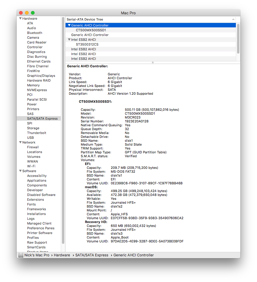

I have a Mac Pro 3,1 2008 with macOS 10.13.6 installed using dosdude patcher.
I have fitted a SEDNA PCIe x1 SATA 3 SSD adpater, link below, and to this have fitted a Crucial MX500 500GB SSD, link below.
In theory I now have a 6GB/s SATA 3 port with a 500GB SSD connected to it. I booted from a USB install media, wiped the SSD, and then installed macOS on it - it is funcitoning as the boot drive. I have enabled trim on the drive. The correct post install patches were installed.

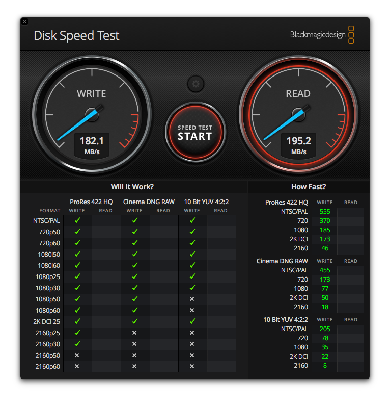

When I run Blackmagic speed test I am getting speeds which seem more in keeping with SATA 2 around 180/190MB/s. Is there something I have missed? Should I not be seeing better performance out of this setup.

That speed looks very reasonable.
PCIe 1.0 x1 provide 250MB/s throughput.
Take 20% overhead away, real world max at about 200MB/s.
And now you can reach 195.2, which is ~98% of the max possible speed already.

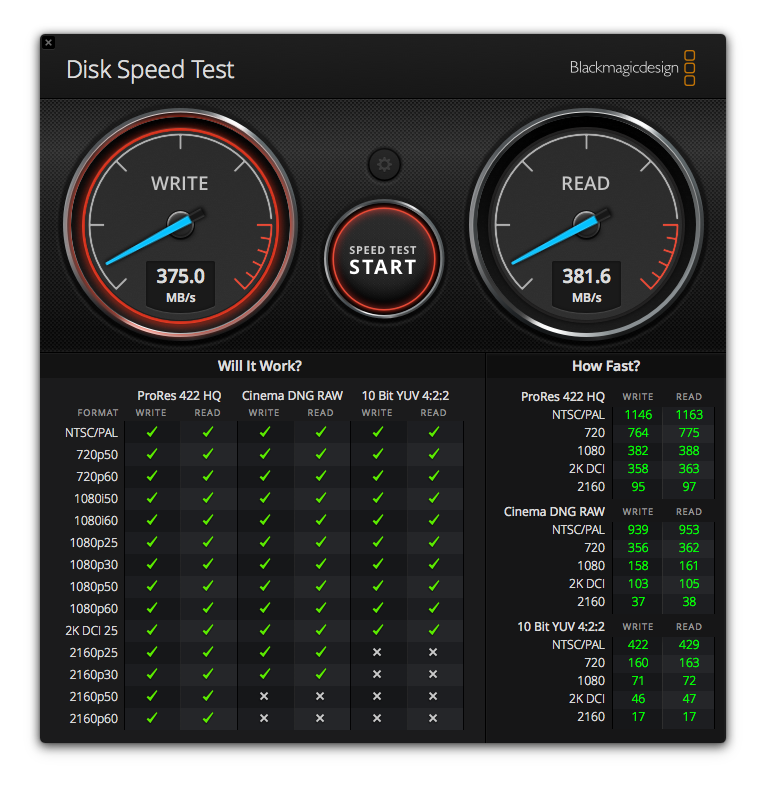

Thank you, your answer has pointed me in the correct direction and solved my problem. I was not aware that the 2008 Mac Pro had a mix of PCIe 1.0 and 2.0 so I put the SATA card as far away from the GPU to prevent heat.
I have moved the SATA card into slot 2 and the speeds are now what was expected!
I guess this can also act as a confirmation for anyone curious about this card that it does indeed work in a Mac Pro as a bootable drive.
