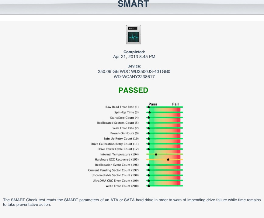

I didn't waste any time after that. After ensuring I had my Time Machine backed up with the latest changes to my system, I ran TechTool Pro on my Mac, and found that the Hardware ECC Recovered range looked questionable, but I'm not sure if i should worry about it.
I did find the kernel panic log, and I wanted to know if someone here would be gracious enough to examine it and let me know what sort of problem my Mac ran into. Based on the TechTool Pro report, I suspect the hard drive, but that might not be it.
I've attached a copy of the readout from the kernel panic log in the Console.app. I've also enclosed a snapshot of the TechTool Pro test result of the hard drive in the Mac.

I think it was just a system hiccup like you suggested, but I'm still wondering about that hard drive ECC issue. I'm going to keep a spare cloned drive handy, in the event that the drive does crash (which is a good idea anyway).
You are also correct about Disk Utility; it's a useful tool for general hard disk tasks, but it is no substitute for a real diagnostic tool. I actually had a chance to visit a local Apple repair shop recently, and the tech there informed me that Disk Utility will not really inform you of a hard drive failure until it's practically imminent, i.e. too late. This is why I double checked with Disk Warrior and TechTool Pro.

I'd also like to add that I did download and run smcFanControl, which reports a low temperature of around 108 to 110°F, and a high of 140° to 147°F when actively using the machine with multiple apps open. I'm not sure how healthy that temperature is for the Mac, and if that is causing it to overheat and shut down. Remember, the TechTool Pro report did rate the hard drive temperature higher than normal, but it didn't seem too much out of whack.
I also try to clean the iMac's exhaust vent in the back and the bottom fans by the speakers routinely, which involves canned air and a soft cloth to pick up stray dust.
I hope this report doesn't mean I need a new hard drive, as that is my other suspicion, again, based upon the TechTool Pro SMART test results.
