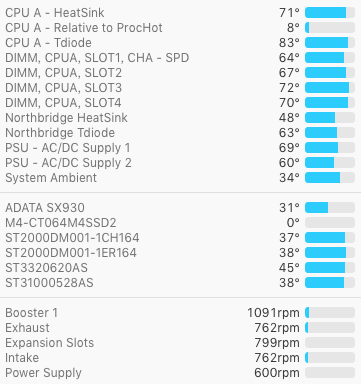

According to iStat menu there’s no unusual temperature behavior apart from the CPU is running much cooler due to the insane fan speed.
Please at least post a full picture of the iStat menu readings.
Otherwise, we can only assume your computer is "normal" because that's what you are saying (except the high booster fan speed), and nothing we can help.

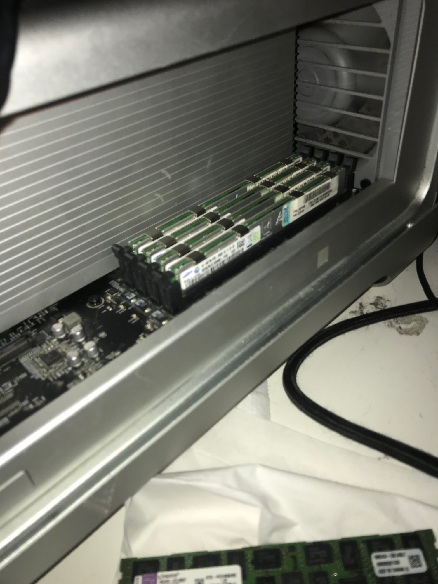

This is probably rare but I'll post my understanding here.
The source of this problem leads to "overheating" RECC memory, I realized the booster fan will speed up in case the DIMM reading get way too high, from my experience the booster fan will accelerate once the DIMM temperature reading is about to reach 75. This of course is not going to cool the memory down so the fan will simply gradually goes to max. The operating temperature of these memory sticks are minus something to 95 degrees, so within their normal temperature range, but obviously the feedback loop of the Mac Pro are designed using factory memory.
I encounter this problem when running memory intensive work, everything goes back to normal if I use only two sticks (regardless of which two) in slot 1,3 or 2,4 so I give them enough space to cool down. I believe the reason is quite simple, they're not full size DIMM and very old (manufactured in 2012), probably manufactured using 45nm or 65nm technology. Running CPU stress test gives me no problem, all three fans accelerate simultaneously. At first I thought it was CPU running too hot and I gave the CPU new thermal pastes, which makes it worse and the two case fan never accelerate because the CPU is even cooler.
If my assumption is right, that's would be a flaw in the fan speed feedback loop. The obvious way to cool down memory is definitely not using booster fan.
Using mac fan control to set the intake/exhaust fan running at 1000rpm will solve the problem. But since these memory sticks are still in their return window so I'll probably return them and get some newer stuff.

This is my istat menu sensor readings under CPU stress test. I was quite surprised when I replace the AS5 thermal paste with Thermal Grizzly kryonaut, I only changed the thermal paste and nothing else, radiator was cleaned regularly. My machine runs silent after the thermal paste change, the biggest noise source now is my hard drives.
I did not saved a screen shot before, but it'll update it here once I can simulate the environment again.
